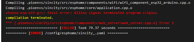

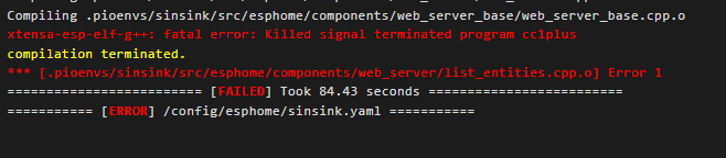

I have a problem lately when upgrading my EspHome devices, I get these errors, what do I need to change?
My system is up to date in all respocts, I cant update those two components in esphome.
The other message is that esptool.py is deprecated, maybe they could be related.

It is not. It is depreciated but still works for now.
What hardware are you trying to compile on?
A Raspberry Pi?
If so you likely do not have enough system resources.
Try this
esphome:
  friendly_name: sinsink
  compile_process_limit: 1  # <--- Add this
Put more memory in your system? What hardware are you using and what type of installation? :thinking:
Did you already check the system monitor when compiling? You might find your limiting factor easily this way :raised_hands:
I am using a virtual machine, I host my HA on a virtual box virtual machine, the components are getting info via modbus from a sunsynk inverter.
The line fixed it, but I seem to have bricked my esphome sprinklers, not related though … :slight_smile:
The you need to give your VM more cores and RAM.

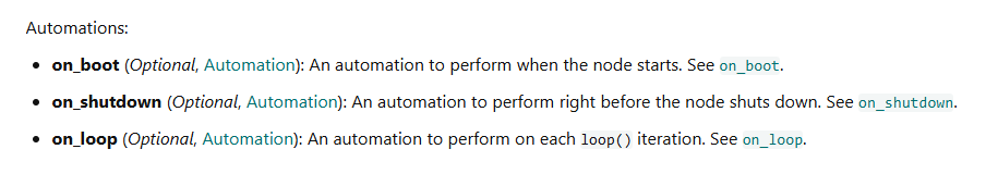

You can automate something with the on_boot action`.
https://esphome.io/components/esphome/

TL;DR esphome compile process gets killed to guarantee system stability because of limit

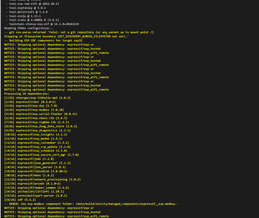

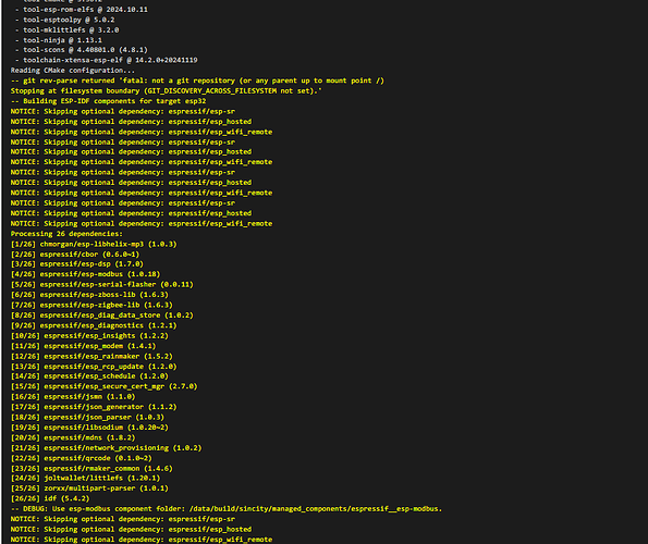

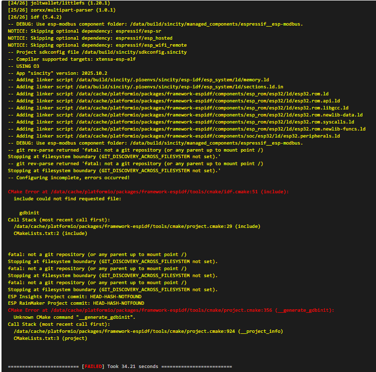

The problem of the esphome component not updating is back, only happens for my modbus connected component, here is the error log, and below is part of the yaml:

Different problem. Delete the add-on with the clear data option. Re-install the add-on. You won’t lose anything.
Thank you, that worked, all components can update now.
