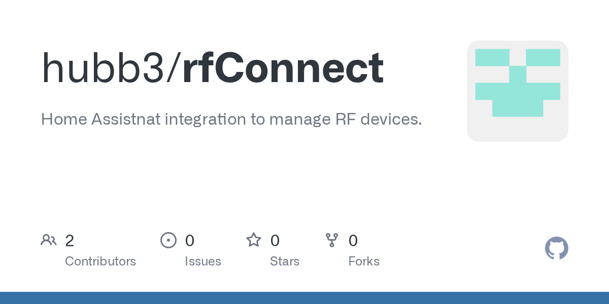

So I created a small custom Home Assistant integration that:
• Learns RF codes
• Lets you add/remove devices directly from the UI
• Creates proper devices in Home Assistant
• Shows relays as normal switches
• Handles multiple transmitters per device to keep them synced with reality
• Receives button presses/events from my old Nexa remotes
• Can also transmit to my old Nexa relays
Now I don’t need to touch the ESPHome config when adding new devices, everything is managed directly from Home Assistant instead.
It simply uses:
  • an ESPHome service for sending codes
  • an event for receiving codes
  • the CC1101 for both TX and RX
this is not perfect but might inspire someone that knows how to do it :smiley:

I think you should reply to the author of that “rf connect” integration.
My mistake. I thought you were also using the RF Connect integration in Home Assistant which is mentioned in post 23 above. But I now assume you are entering the codes directly into the Esphome code.
I have 30+ Esphome devices which I’ve flashed so I’m fairly familiar with using Esphome, and sorting out issues with it! All the wifi settings are correct as it’s connected to my wifi, Home Assistant has discovered it and added it and it’s web page loads and show the logs, which show it receiving the code when I press the button on the remote. So it all appears to be working.
The problem I have is getting the RF Connect integration to see the codes in Home Assistant. If you’re not using the Rf Connect integration then you wouldn’t have had the same problem as I’m having.
I’ll have to reply to @hubb3 to see if he can help, but as he hasn’t made any other posts in this thread I’m not sure how active he is. And his github page has no had no issues or pull requests so far so I assume no one else has had this problem. Or no one else has used it!

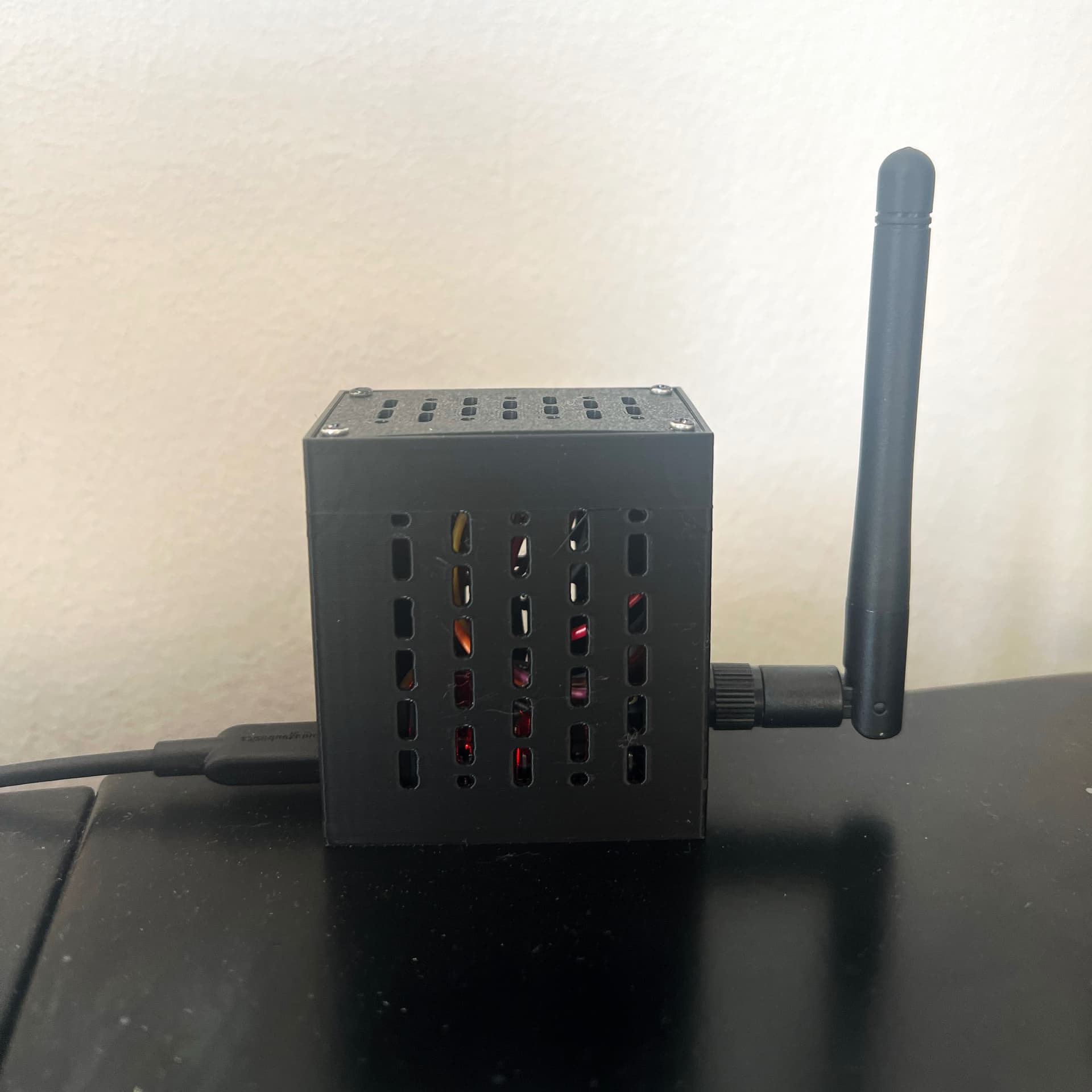

Created and printed a small case for my ESP32 & 8266 with the CC1101 Modul
If anyone is interested, I published the case on MakerWorld:
https://makerworld.com/en/models/2499947-esp32-cc1101-rf-module-case#profileId-2748098
