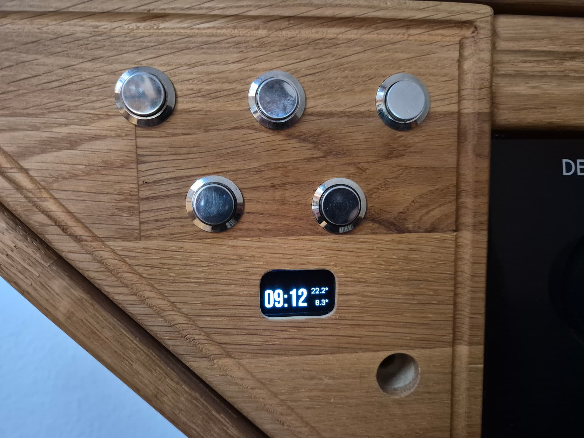

I have a 1.3" OLED display connected to an ESP8266 via I2C with 5V GND, SDA, and SCK. The display shows the current time, as well as the indoor and outdoor temperatures. My problem is that the ESP doesn’t connect to the Wi-Fi after a power outage. Only when I disconnect SDA and SCK does the ESP connect to the Wi-Fi. Then I can reconnect SDA and SCK, and everything works fine until the next power outage. Does anyone have any idea why this is happening?

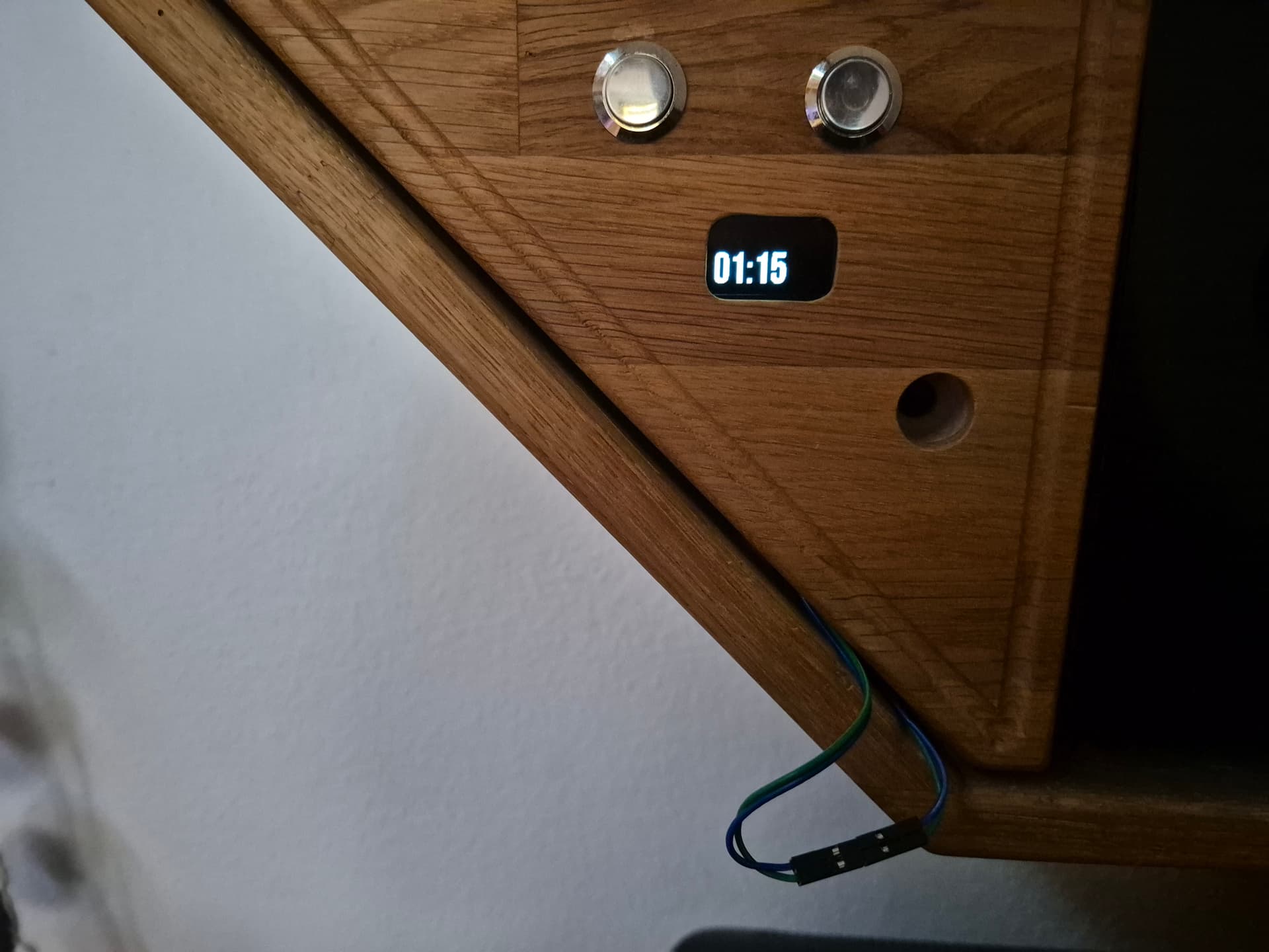

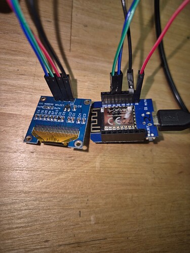

According to the picture you are using a D1Mini board and shoud use the configuration
esp8266:
  board: d1_mini
With the D1Mini setting you should have 4MB instead of 1MB flash memory avaiblable. I don’t know if this will help you in this case.
The problem with my ESP8266 projects is that these ESPs have relatively little RAM (less than 40kb available for programs). When memory gets low, my ESPs usually start having problems with the Wi-Fi (they can no longer establish a connection), and with higher memory usage, they crash completely.
The ESP8266 is perfectly suited for reading data from a few simple sensors, but when more memory is used (components with read/write buffers, long LED strips, large displays, fonts, etc.), they quickly run into problems. A 128x64 display usually still works with a D1 Mini (even with a few sensors).
Try adjusting the D1 Mini settings, and if that doesn’t work, try using one less font or a different font.
Oh (second reading) - you only have this problem after a power outage. Then I would also try the D1 Mini setting. Perhaps the ESP01-1M has different configuration pins (it has far fewer pins than the D1Mini) and therefore doesn’t like the wiring at startup.
The wiring shown in the picture isn’t really reliable either. After plugging and unplugging it a few times, these cables no longer connect reliably. If everything works, then I would solder the wires permanently.
Another problem could be the power supply. Many USB chargers and power banks shut off if a minimum power draw isn’t present. Perhaps the ESP with the display is right at the limit. Or the opposite, the power source is too weak and can’t supply the increased power consumption during startup and establishing the Wi-Fi connection.
Have you tried a different power source, perhaps also with another device connected?
Try running it with usb cable to your computer so you can see the log in esphome. That might give a clue.

I changed the board name to d1_mini, but its the same problem.
I also tried other GPIOs without success.
See if this posts code above sorts your problem. It may just be the update interval default is too low.
Some info about your display?
You power it at 5V, if it has pullups to VCC, you get in troubles with Esp.
I changed the update_interval to 2 seconds and it works as it should. Thank you so much for that. The display was my first microcontroller projekt, long before I started homeassistant. The i2c bus also worked with a 20m cable and amplifier to the Raspberry. Mostley…
Does that mean the display was trying to query data every second and probably using a lot of power, and the ESP couldn’t connect to the router in that time? With 2 seconds, the ESP should be able to do that, right?
I also tried setting the frequency of the i2c to 800khz. This also works with the preset interval of 1 second. I’ll stick to the 2s variant though.
