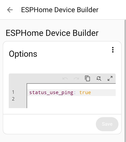

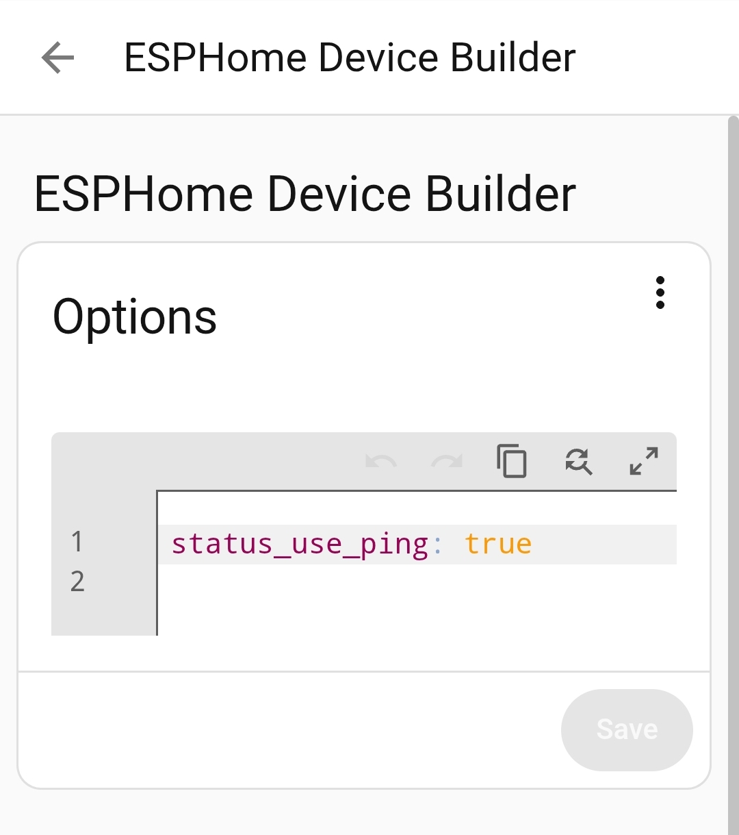

Any joy if you switch esphome app to pings instead of mDNS
Change in configs in esphome
How do you find this config file? I can’t find it.
Yiew config as yaml
