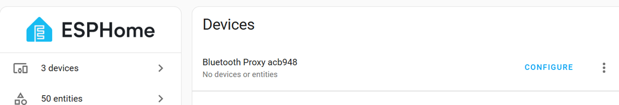

I attempted to remove and reinstall the proxy using the esphome ready-made projects page (Version- esphome.bluetooth-proxy 25.12.4) ; however, the issue persists. Although the device is detected and successfully added to Home Assistant, it does not display any Bluetooth devices, as shown below.

It is normal that you do not see devices or entities for just a proxy, unless you specified other functions on it. Bluetooth devices detected appear at their respective integration (for instance Xiaomi, Inkbird, Switchbot…)
Is anything you hoped to connect not working? If so, did it work before, what kind of device, etc…

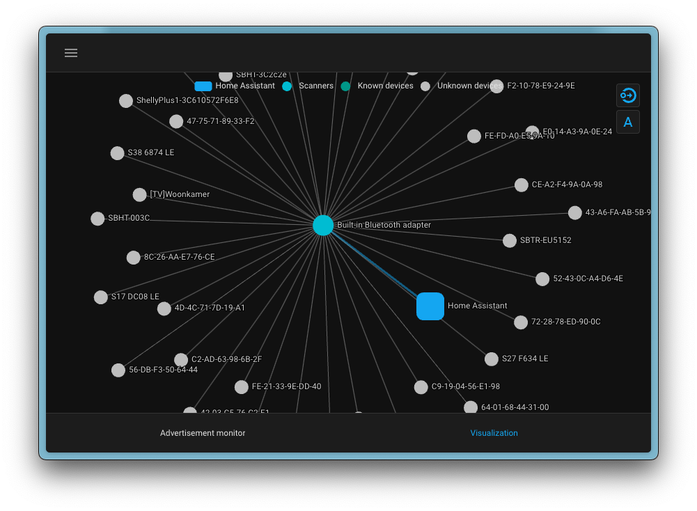

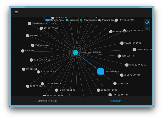

You actually can visualize all devices connected via Bluetooth proxies in HA :point_down:

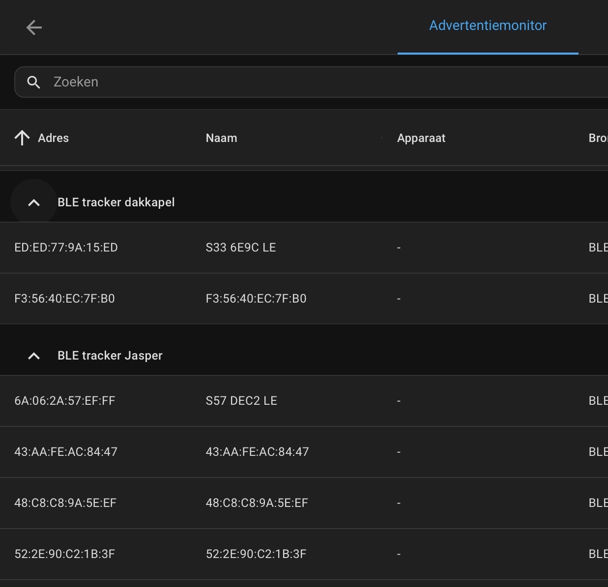

The bluetooth integration in settings has an advertisement monitor. It should show your proxy and the devices it detects. (If you installed the latest HA beta the pge has moved from the integration page to the top level settings menu).
