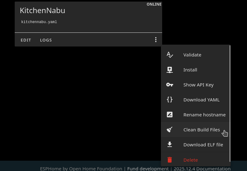

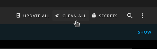

My suggestion, clean build files and try again.

That is the VERY long way around clicking the ‘clean build files’ button…

`Clean Build Files` action in ESPHome Builder fails when config is invalid · Issue #6726 · esphome/issues · GitHub may be relevant, but was closed…

Uninstall and reinstall will bypass the potential clean files build issue. Waiting for the next release will possibly not resolve the issue.
