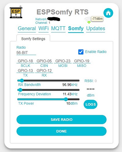

Thanks for all your work on this @rstrouse… just getting my hardware set up now. Everything looks fine, but I don’t get an RTS signal from the remote (and hence nothing in the logs). Any tips for troubleshooting? I did wonder if it might be a pin-out issue as my ESP-WROOM-32 has a slightly different board to use, but I mapped it against yours and the radio seems to be enabled.
Make sure GDO0 and GDO2 are assigned to TX and RX respectively.
Hmmm… pretty sure I have, but still nothing… this is the pinout I’m using (I’ve overlain your usual connections):
This is a screenshot of the setup interface:
Sorted… had pin 8 and pin 4 (both with blue wired) switch! Thanks so much for the awesome project!
Yep that will do it. Glad you got it sorted!
