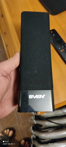

As I know esp32s not yet supported. but I think that soon they will add and your board is very good. df player and esp32 I use it quite successfully. you can see on the photo
