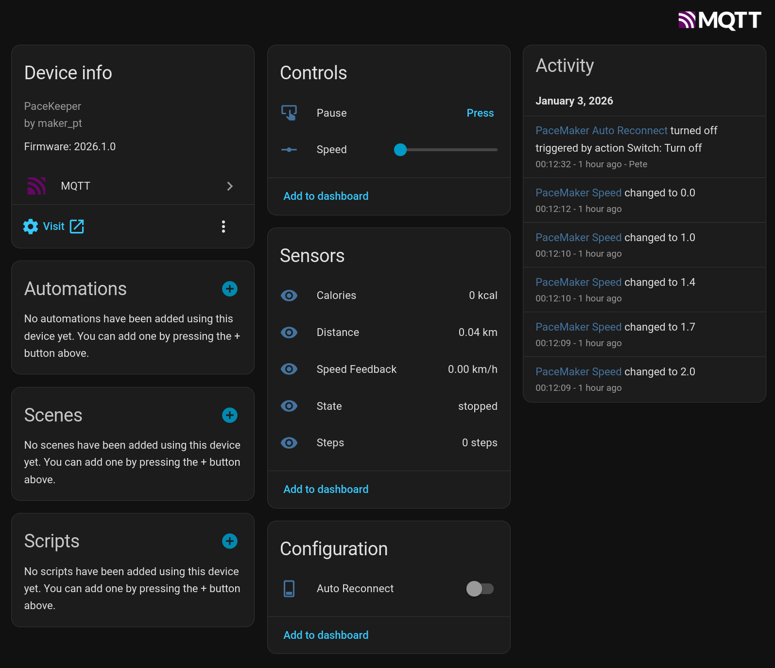

I built a small Bluetooth to MQTT bridge that allows to connect Superun WalkingPads to Home Assistant.
The use case I’m realizing is that I want to move my desk up and start the walkingpad via a voice command. The WalkingPad is finished and the prototype to control the desk is also ready.
I have tested it with a “Superun BA06-B1” which shows up as PitPat-T01 Treadmill via Bluetooth. It might work with others too.
