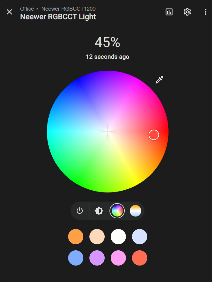

Hi All,
I’ve created this to control the Neewer RGB1200 Light from Home Assistant via ESPHome.
My Neewer RGB1200 GitHub Repository
All you need to do is place your Light MAC Address in the main .yaml file. you can add your encryption Add your local wifi credentials if you don’t already use the “!secret wifi_ssid” and “!secret wifi_password” with your ESPHome.
Feel free to add you comments or updates but let me know :slight_smile: I may add the Neewer CCT660 later.
