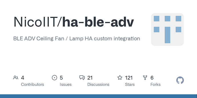

Did you ever find a solution to this?
EDIT
Solved with below
requires
hacs addon
bluetooth or ble proxy
custom ble_adv component if using ble_proxy
works amazing
BLE ADV Ceiling Fan / Lamp HA custom integration

I didn't find any way to interface with them. What I did notice is that there are a number of fans coming out, being sold by AliExpress that use Bluetooth via an app for control.
There is a popular hacs add-on that apparently works with many of them. I am still waiting for my new fan with Bluetooth to arrive:)
