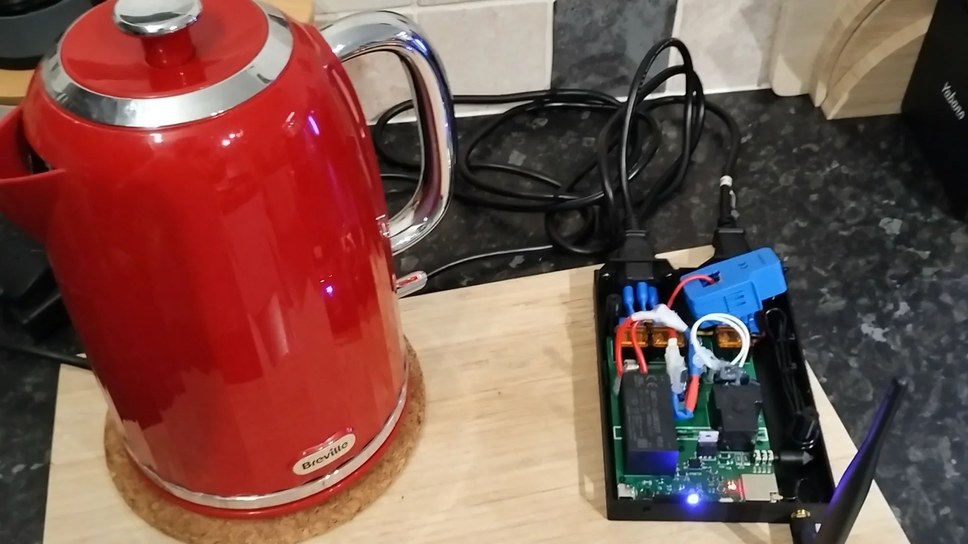

So after years of various different UK AC smart switches failing, overheating etc on me I decided to have a go at rolling my own one. It’s nowhere near as compact as the ones you can buy but it’s rated well over 13 amps (should be about 15amps and the relay i’m using is 30amps just to be sure :wink: )
I’m currently waiting for a new case to print, wasn’t quite the right fit in this one and you’ll have to excuse the video quality too :slight_smile:
Screenshot of it hitting 12amps with the kettle :slight_smile:

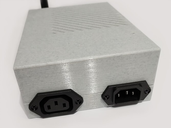

I still have lots of off-the-shelf units in the house, but I’m now using my custom units for heavy duty loads. Case pics as promised :slight_smile: (haven’t screwed the case together yet so excuse the ugly gap)
I hate to be negative about this, but what’s the flammability of that case material like? PVC junction and project boxes won’t support a flame, but I’m a lot less certain about 3D printable materials (i.e. I have all my mini-relay modules in electrical junction boxes for just this reason).
Completely agree, I wanted to get some metal cases made up but no idea where to start there to be honest…
It does have hard thermal cut-offs at 80C which is well below the burning temperature of PLA, at least. :slight_smile:
Are those IEC 60320 C13 Connectors and C14 Inlets ? Pretty sure they are only rated at 10A in the UK ?
Indeed they are :slight_smile: I’m not using the ones with IEC connectors for more than that other than the brief kettle test :wink:
Speaking of 10A ratings in the UK, you should check the cables/connectors on your kettle, you’ll be surprised :slight_smile:
Kettles have a different connector, C15 and C16
I had a look around and there are companies selling 13A rated C13 power cords
Have a look at the AWG of the cable they use though, most are rated 10A or less but they get away with it because of the short duration of use.
I think as you said all C13/14 are only rated at 10A in the UK… the ones I’m using actually say 13A on RS, but on the plugs they clearly have two different ratings, 13A and 10A which I assume is for the UK.
I was looking around for better connector options for these that could actually be rated at 13A - ideally wanted to use a BS1363 socket for the load connector but C13/14 was the quickest option in the end since I’m not actually using >10A at the moment.
