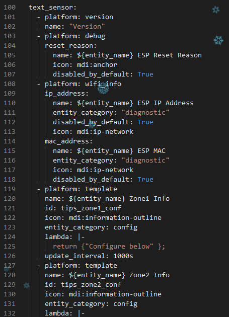

The first setup must be done via ESPHome Web requires a browser that supports WebSerial.
LD2450 Configuration
You need to add the YAML file to the ESP32 module’s base YAML file.
Save the Zone H file to the ESP directory in the Home Assistant app.
In order to use the Plotly Graph file, you must have downloaded the Plotly Graph card from HACS.
You can find the GitHub linkhere
