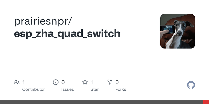

I understand they were working to allow zigbee in the arduino ide, but I haven’t followed it. I’ve been using esp-idf with the ESP32-C6 or ESP32-H2 and it has worked well. The super mini clones are very cheap, the range isn’t great but hard to beat for the price.
Some examples:
