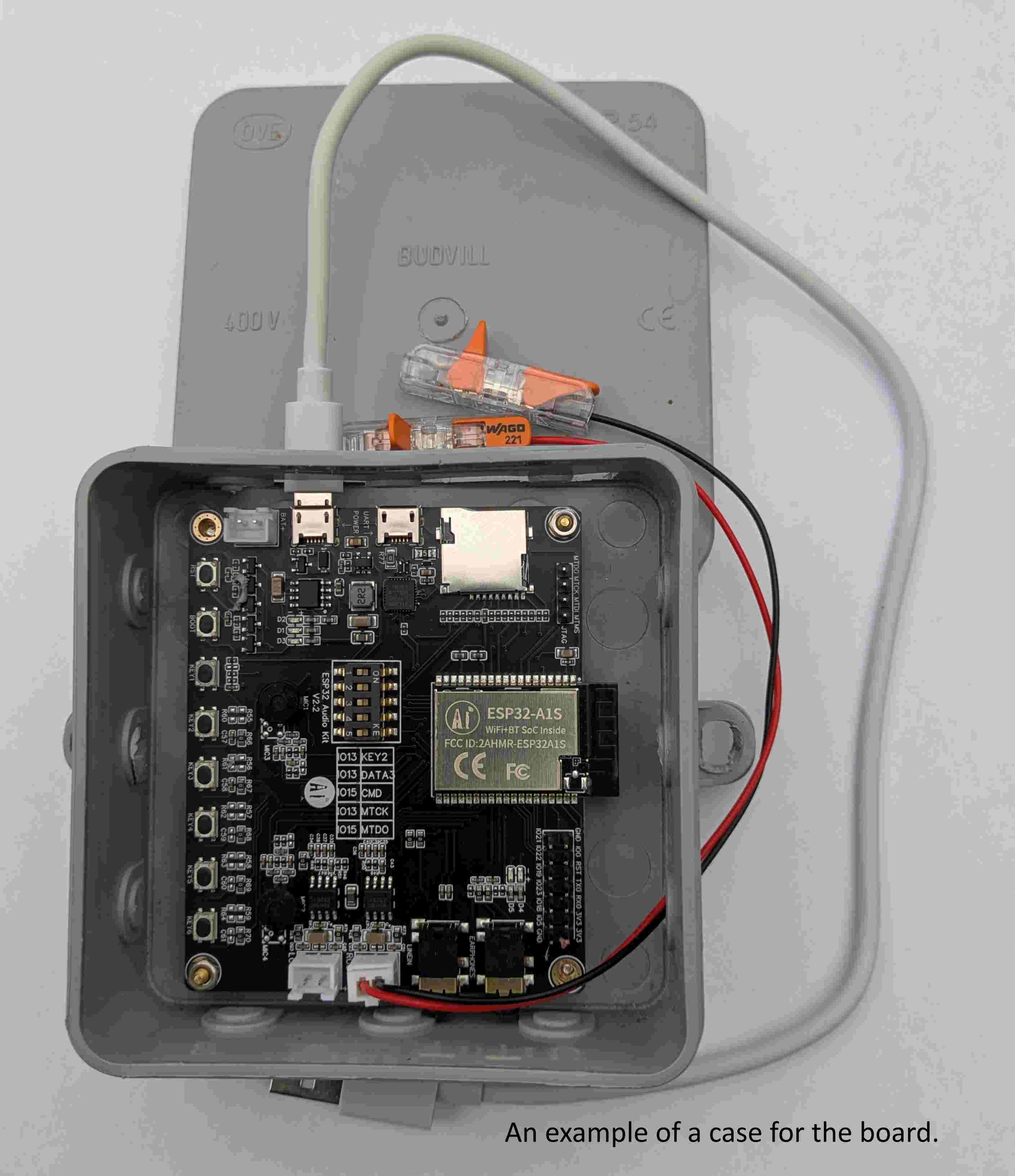

I’d like to introduce my new project: a smart home TTS/MP3 player, based on an ESP32 audio kit and fully integrated into your smart home system via MQTT.

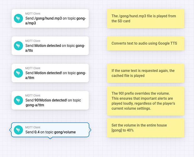

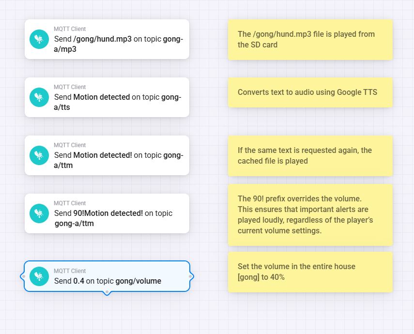

  • TTS text can include a prefix that overrides the volume, for example:
    80! Water in the basement
    This ensures that important alerts are played loudly, regardless of the player’s current volume settings.
5. MQTT control
  • Fully controllable via MQTT
  • Compatible with any smart home system that supports MQTT
  • Commands include: mp3, tts, ttm, volume, stop, reboot, and more
