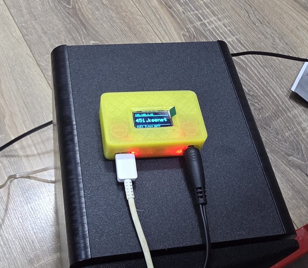

I’d like to share my ESP32-based Home Assistant notifier project:
GitHub:
This is a custom PlatformIO firmware project for an ESP32-based Wi-Fi audio notifier / speaker for Home Assistant.
Main features:
  • local web UI with separate HTML, CSS, and JavaScript assets
  • Wi-Fi station mode with fallback AP configuration mode
  • MQTT command and state bridge for Home Assistant
  • I2S audio output for MP3 streams, radio streams, and URL-based TTS playback
  • OTA update support from GitHub release or manifest URL
  • battery voltage monitoring
  • OLED status display support
  • saved settings in Preferences / NVS

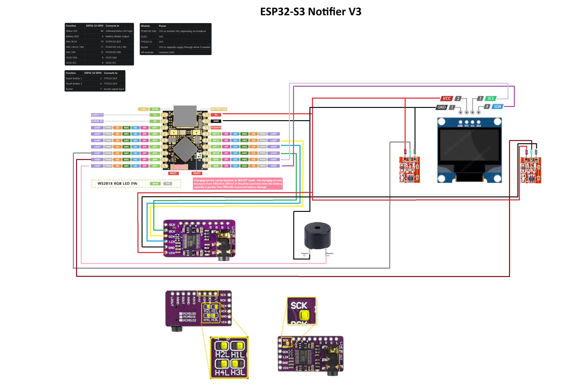

Current documented hardware is based on:
  • ESP32-S3 Super Mini
  • PCM5102 I2S DAC
  • 0.96" I2C OLED
  • two TTP223 touch sensors
  • buzzer
The project also includes:
  • hardware documentation
  • circuit diagram
  • STL files for the enclosure
  • a dedicated firmware profile for Home Assistant media-player use with bkbilly/mqtt_media_player
This project is not ESPHome — it is a custom modular PlatformIO firmware intended to be buildable and extendable.
