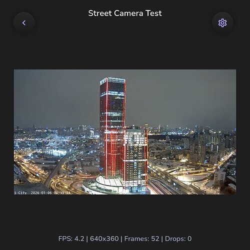

The PPA works correctly with the ESP32-P4 only on the master branch of LVGL (LVGL 9.5), which isn’t yet released. I was able to run a stream from Home Assistant cameras on our device, not on ESPHome, but on ESP-IDF. The source resolution is up to 1920x1080. The output is 640x360, with FPS fluctuating between 2 and 8 without any loss of quality; it’s not yet fully stable. But that’s on an RGB888. Results should be significantly better on an RGB565. With reduced quality, you can get around 20 FPS.
