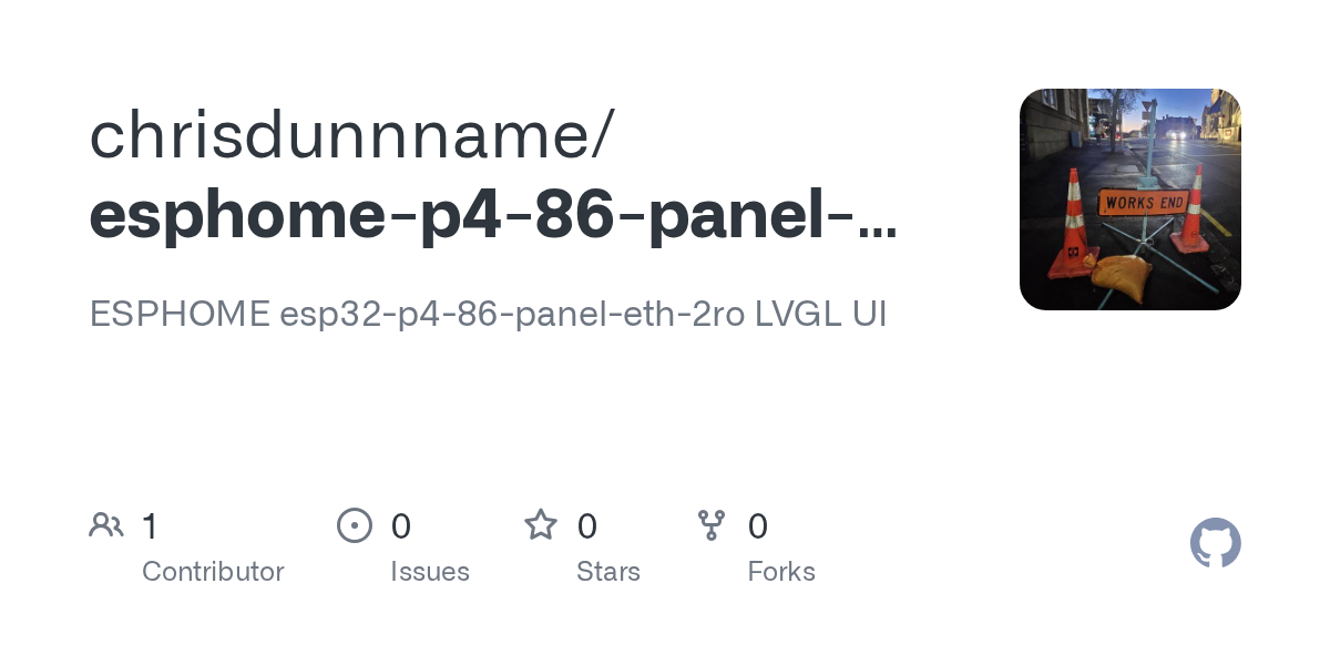

Chris Dunn has done a nice setup based off of his work started by BigBobbas work on the S3 Box 3.

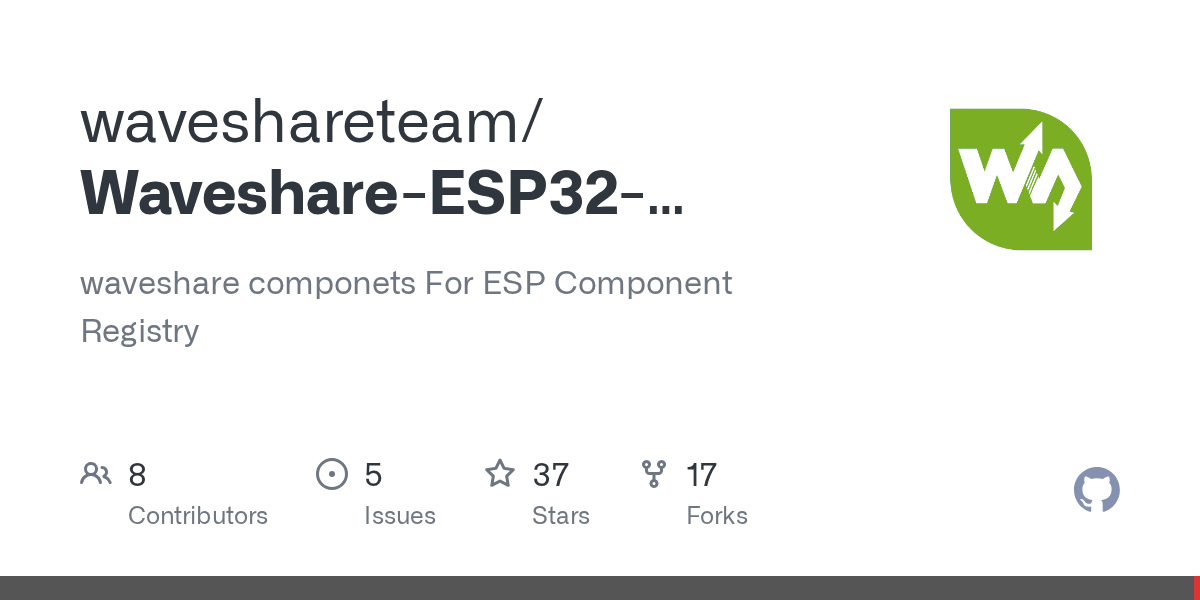

What does it mean to limit development to the ESP32-P4? The project is already being developed for a specific device. Waveshare has its own BSP for this device:
However, the standard display configuration isn’t suitable, as it severely limits the use of PSRAM buffers. Furthermore, the hardware JPEG decoder requires a DMA buffer link, and if the heap is corrupted or fragmented, everything will crash. This can be somewhat alleviated by making the buffer allocation a singleton, but this also has its own side effects, but it always guarantees a DMA link allocation. The problem isn’t how to get the camera stream working on the device; the problem is ensuring it doesn’t crash and delivers a stable FPS when your project has a ton of features, including a Vue web server, a full-fledged websocket with HA, a bunch of complex widgets, neomorphic buttons, a voice assistant, ARGB888, and so on…
