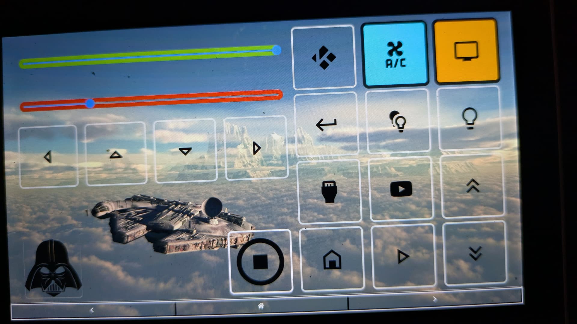

I never used EZZ studio before but here’s a walkthrough using this board granted he had to use AI and LVGL docs to get it working but pretty nice layout. Here is the YAML

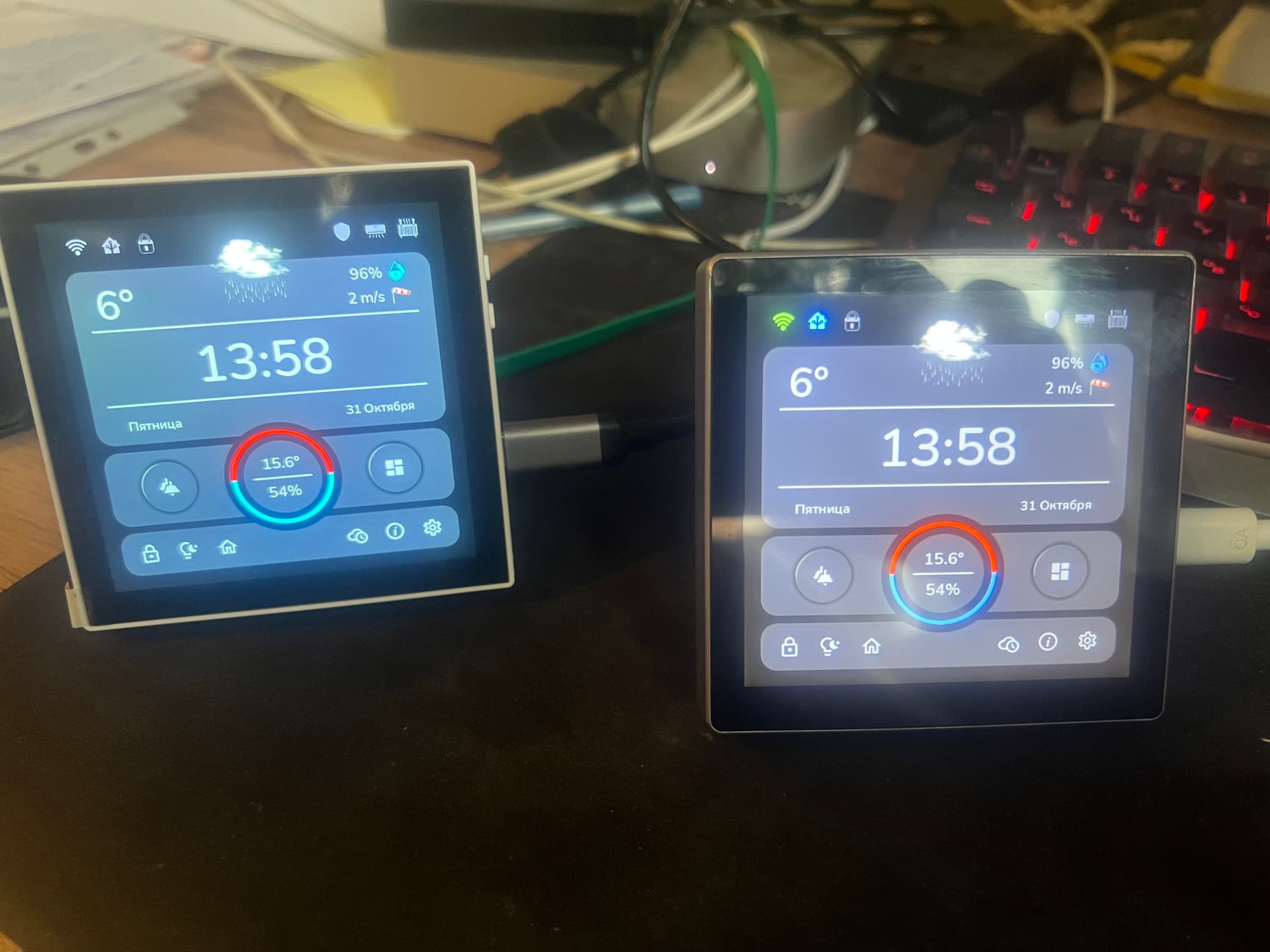

As for the example, these are the first tests. Things are much better now, but it hasn’t been published on GitHub yet, but the first demo version will be out soon! Here’s an example; that panel is on the left.
what is one to the right?, the old 4848s040 (esp32-s3 no mic) or the new ESP32-S3 Smart 86 Box (dual mic) ?

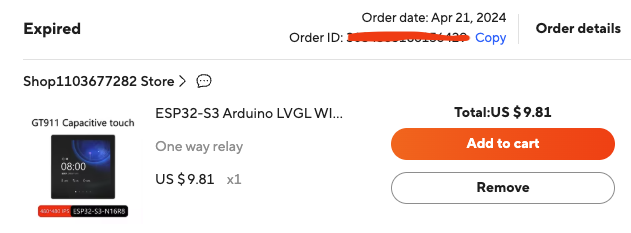

fun story, i bought the first 4848s040 in april 2024 for 10 bucks (including shipping), prices sure changed after AI became the buzzword :sweat_smile:

i’m replying to Alexay’s comment “Here’s an example; that panel is on the left.”, so i’m asking, then what is to the right? :man_shrugging:t3: simply wondering what he is comparing the p4 with, screen difference…
@RealDeco @katagia On the right, that’s the old Guition ESP32-4848S040. I’m almost done with the Guition ESP32-4848S040, though I did encounter some issues with the stack. I think I’ll be working on porting it to Waveshare in a couple of weeks, tops. I should be able to get a demo up and running in a week, tops. Once I’ve uploaded it, we can discuss audio and microphone issues. I think a lot could change in that time, as the guys at ESPHome are constantly working on it.
big color difference, guessing the p4 that is closest match to used color code :+1:
I think it depends on the display matrix, since both Guition and Waveshare use RGB565.
you mean the old guition s3 without mic vs the new waveshare s3 with mics?, it could be a older model of the display :man_shrugging:t3:
i only have the old ones but looked at the schematics for the new s3 with mic, looks like shared i2s bus, not that exciting, but if i should try one of those, the new s3 with mic or the p4, which one would you suggest?
Let me try to explain a little. There are the physical properties of the matrix, such as resolution, contrast, interface (MIPI DSI, RGB SPI, etc.), and so on. And then there are the physical capabilities of the microcontroller.
On the S3, you won’t get RGB888 colors, no matter what the matrix is. In principle, you won’t get… only RGB565, meaning 16-bit instead of 24. On the P4, you can without any problems (but not yet with ESPHome). In my screenshot, both screens are running in RGB565 mode, but the image on the Guition seems richer, and the color difference is precisely due to the matrix.

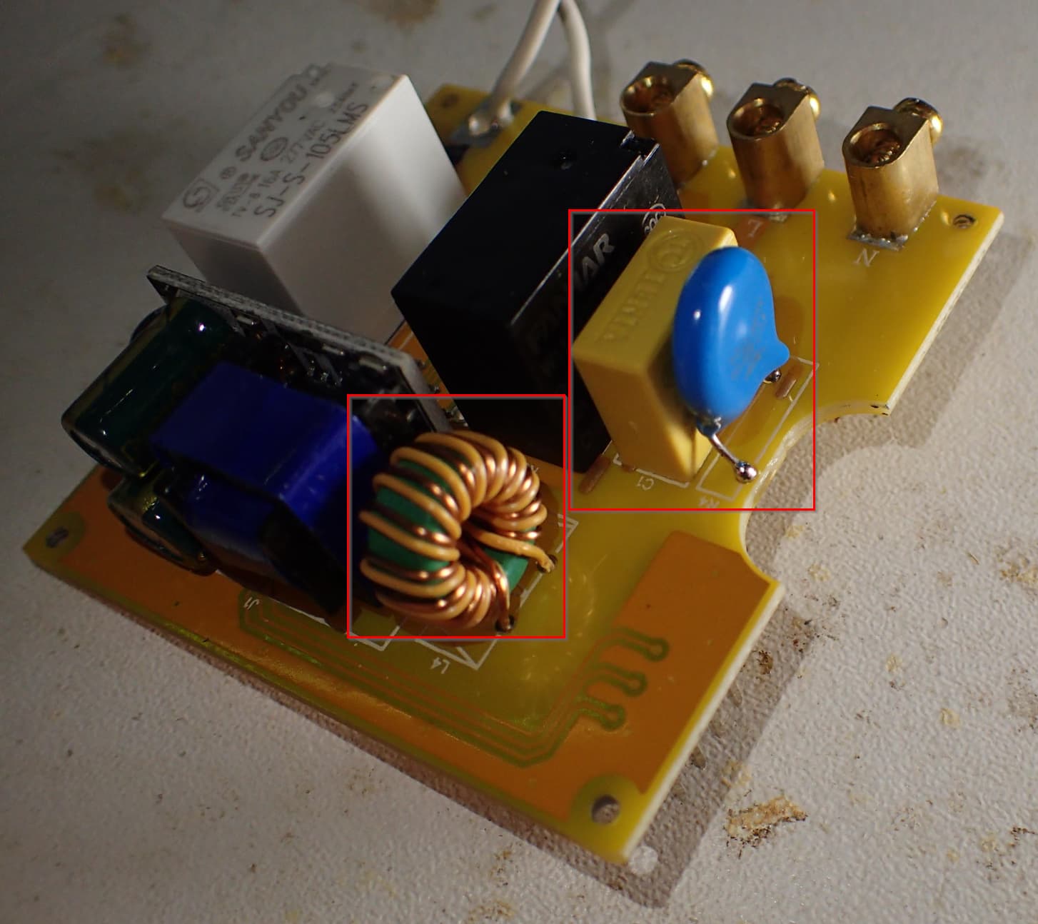

Have you disassembled your device? Are there any security components?
In my versions only inductors were missing. I soldered what i’ve had… can’t remember value, i think it was in 10-100uH range. But that inductor is just a noise filter, nothing more.
