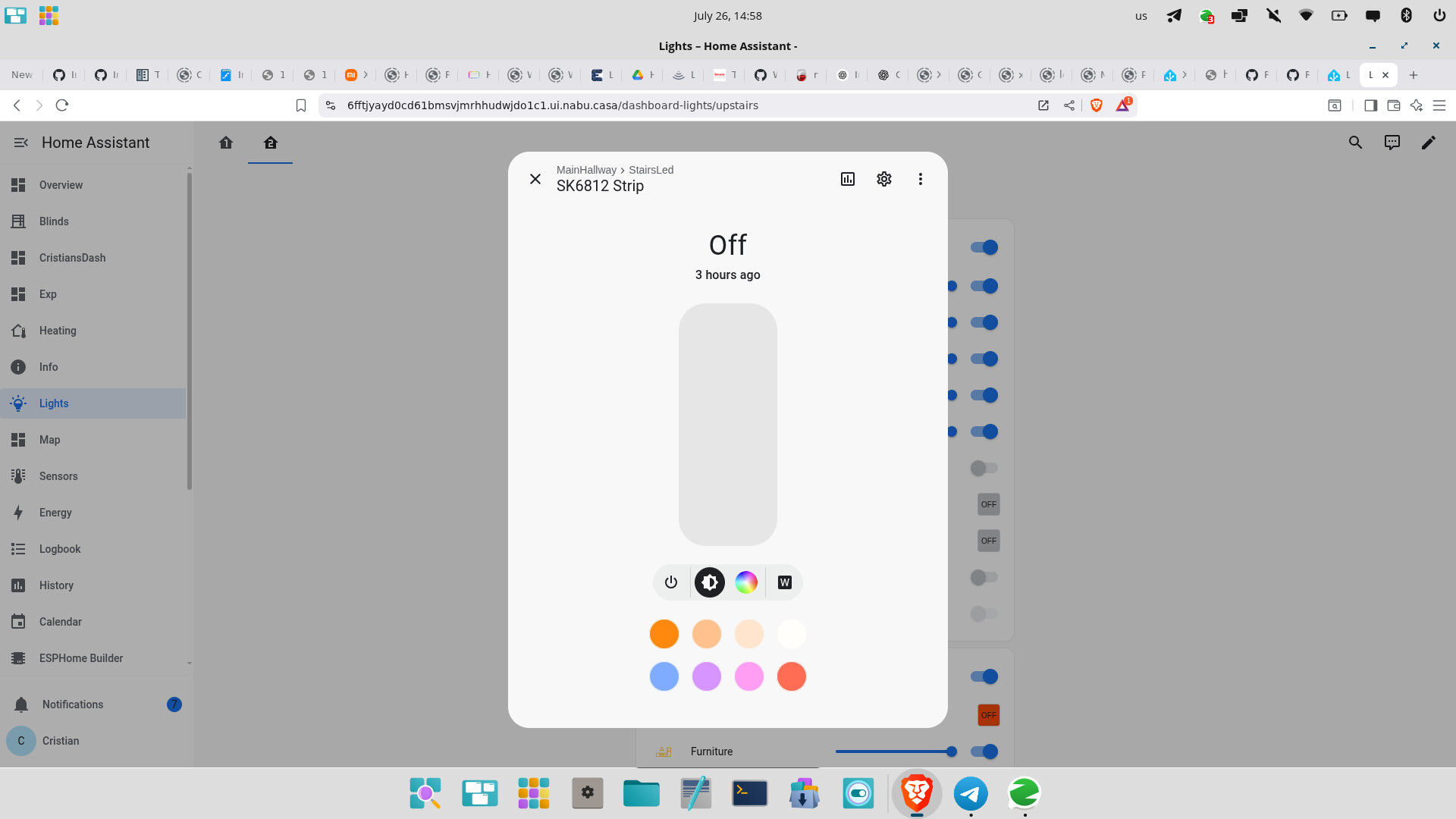

Hello I had made my stairs with 5V sk6812 and Wled and I had trouble making segments so I switched to esp32 RMT Led strip in esphome. It is much more responsive and it was so much easier making my segments.

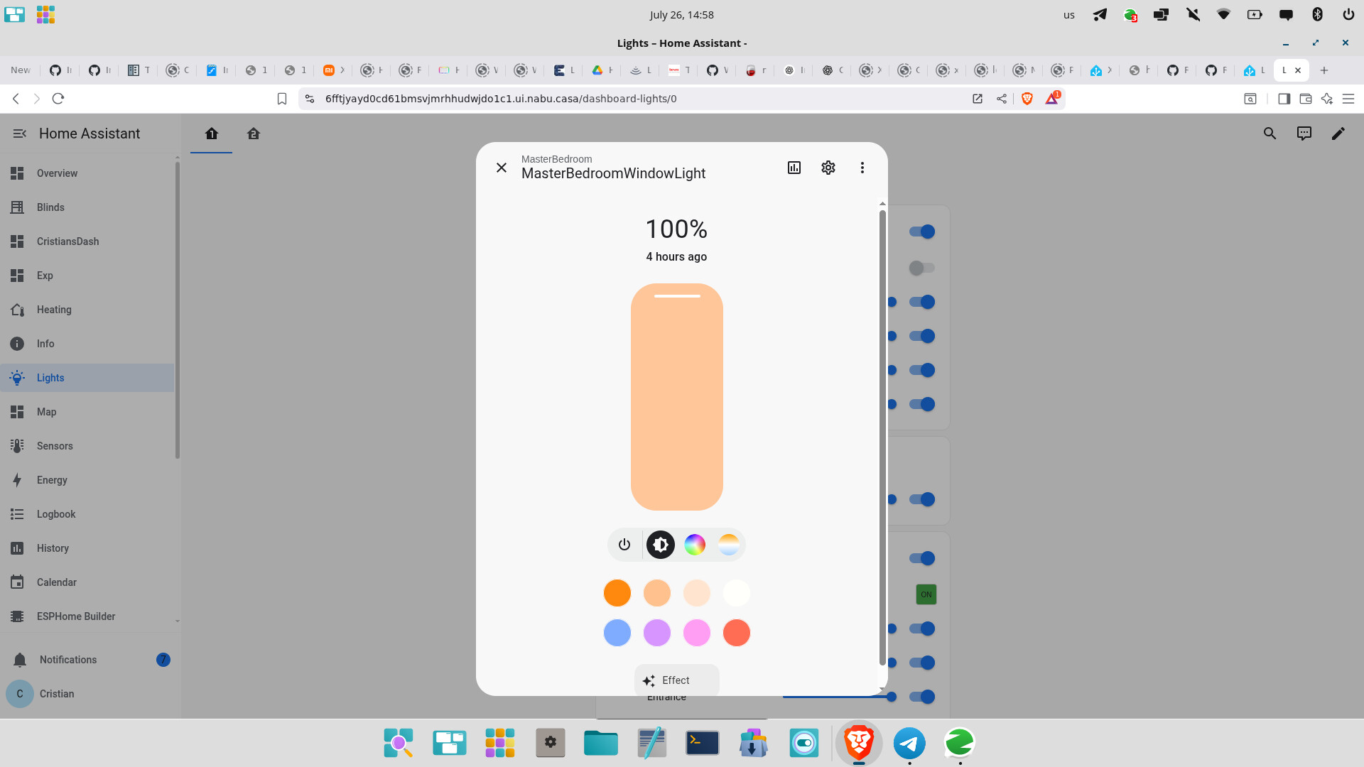

My problem is I wanted to add Effects but I do not have the button for effects under the light. I attached 2 pictures like one light from Hue that has effects and my esp32 with light that does not have the effects button

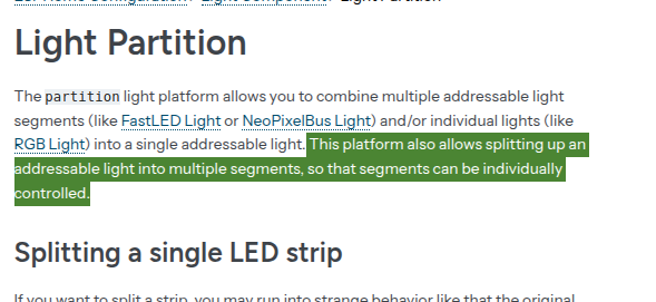

This goes back to what i said about reading the documentation/instructions. Heres a sentence from the very first paragraph of the Partition docs.
“This platform also allows splitting up an addressable light into multiple segments, so that segments can be individually controlled.”
You’ve split up a led strip and turned it into multiple lights, thats why they have a configuration option for naming your newly created lights since thats essentially what you have instead of a single steing of led’s (1-50). Now you have 3 lights (0-25, 26-50, 50-100) as an example.
Ok thank you for the feedback. I did read the documentation multiple times but it’s hard when you don’t understand it 100%. Still that does not answer my question.
The lights work just fine, but I do not have the effects dropdown on the light and I do not understand what I am missing from my yaml.
I will try your suggestions, but can you tell me why the effects button drop down to select is not there?

I know what am I doing and what I am trying to achieve, so I will explain it again. I am using the segments like this because I want to control each individual steps so i can use automation to turn them one by 1 when motion is detected. On the full strip though if you look at my code i tried putting the effects under the full strip so sometimes I can have effects on the whole strip if I party or for Christmas. Does that make sense?
so to answer your question with another question because it is the thing that I do not understand, how do I assign the effects to the whole strip? what am I doing wrong?
