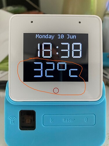

hello I managed to get your firmware to work:
Which I find great on my esp32S3BOX3 but the microphone and the sound do not work on the device it is probably directed to another id I tested several methods it does not work can you help me thank you
