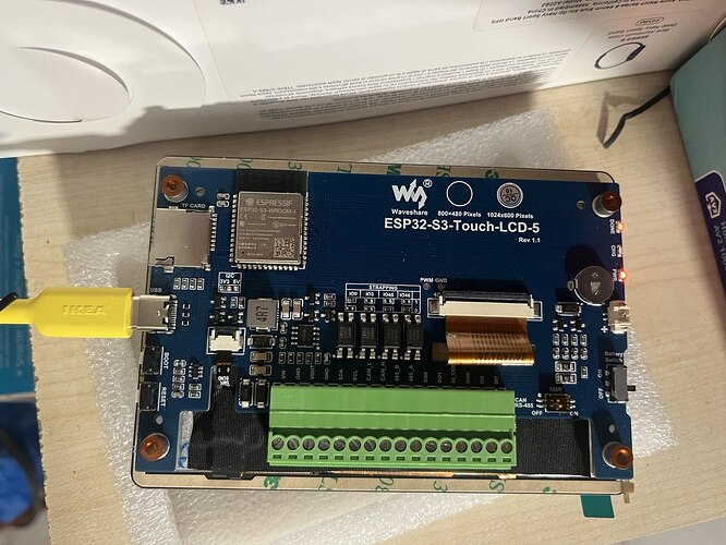

I purchased a 5" ESP32 Touch Display (1024 × 600) hoping, with the help of ChatGPT, to create a small Home Assistant control and information panel.

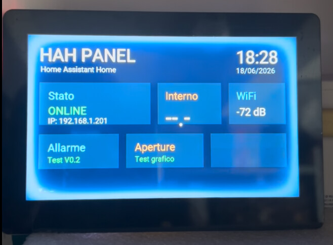

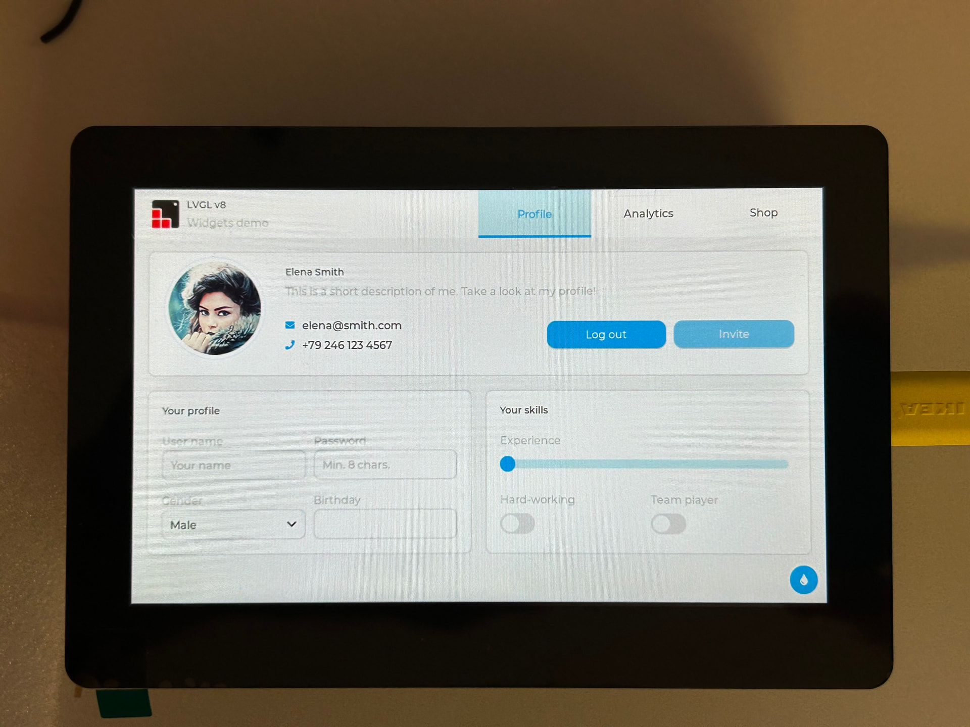

Unfortunately, I had to give up because I couldn't solve a specific display issue. The original demo that came preinstalled on the device looked perfect when I first powered it on. However, as soon as I flashed a custom firmware, the LCD started showing a white border around the entire screen.
You can see the issue in the attached photos.

Could you please provide your code file ? I have had the same issue with this waveshare esp32 in the past
It’s caused by the wrong init sequence.
