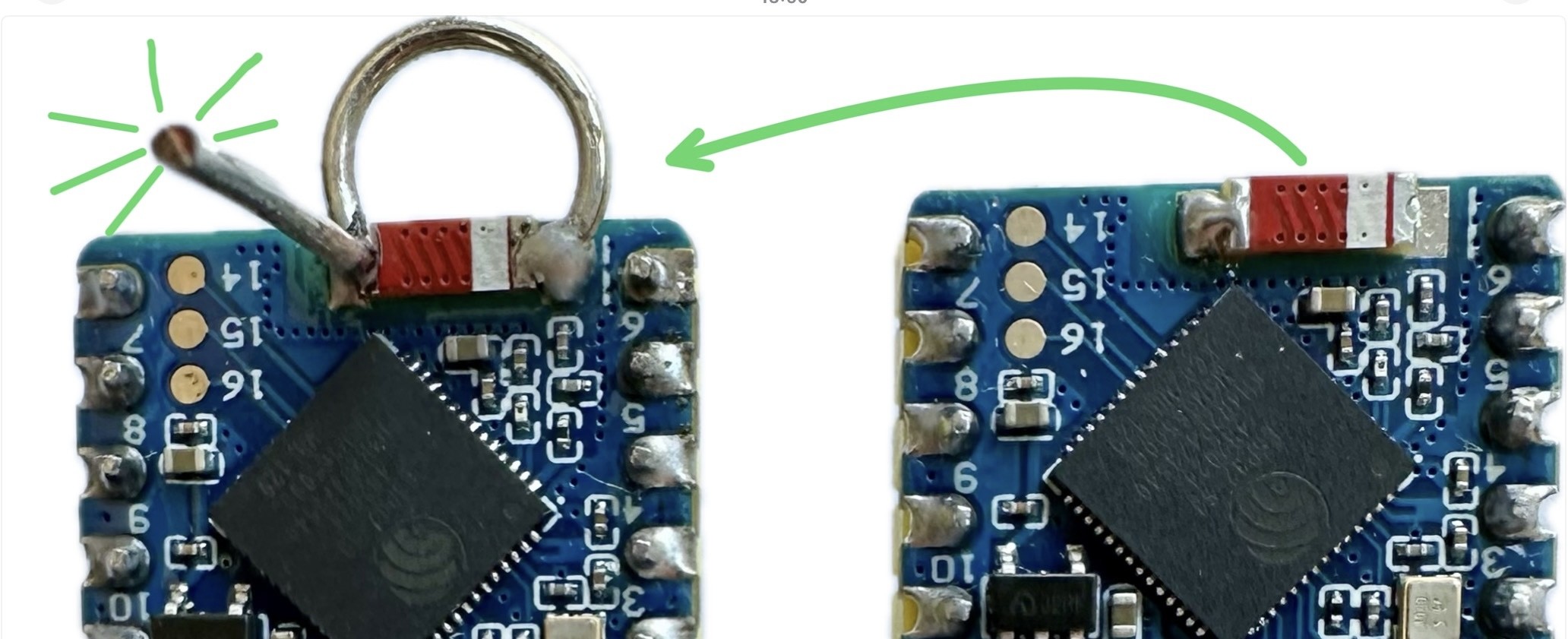

Carsten sent me this link as well:
I haven’t tried it yet, though.
Thanks a lot. Just tried it and it did the trick, cannot believe it! Thanks again!
