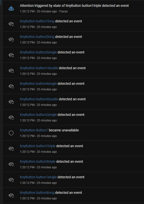

ESP32 supermini using ESPhome running automations on boot/shutdown
I am trying to enable a few multi-purpose buttons around the house. 4 buttons per device, 4 actions per button. I have finally gotten the inputs and events to work as intended, but my automations/events are triggered on boot. I have enabled the debounce filters (delay_on_off: 100ms), but all attempts have failed to stop boot triggers. Considering these devices can be tied to up to 16 HA actions if all actions are triggered every time power is removed and restored or every time ESPhome pushes an update, it will be a chaotic mess if I can’t mitigate this issue. Any help is appreciated.
TYIA

You could use global variable boolean as a flag. Then set that flag true on on_boot. And on your binary sensors check that the flag is set.
 on_boot:
    priority: -100
    then:
      - delay: 1s
      - lambda: |-
          id(boot_done) = true;
Pardon my ignorance, but what is allowed a conditional operation, I know .yaml does not support 'if(x == y then()). Is the condition of boot_done = true the event gate or the event.trigger gate?
Lambda does. But you don’t need it.
globals:
  - id: boot_done
    type: bool
    restore_value: no
    initial_value: 'false'
So the on_boot sets the boolean and your binary sensor checks it
    on_multi_click:
      - timing:
          - ON for at most 0.5s
          - OFF for at least 0.2s
        then:
          - if:
              condition:
                lambda: 'return id(boot_done);'
              then:
                - event.trigger:
The event is still being triggered. I installed it again to be sure that it wasn’t triggering during the shutdown. I added my new code in case I misunderstood or mistyped something.
esphome:
  friendly_name: tinyButton
  on_boot:
    priority: -100
    then:
      - delay: 1s
      - lambda: |-
globals:
  - id: boot_done
    type: bool
    restore_value: no

I also added more time to the delay. should the delay priority be higher?
Have a look at your esphome logs to see what’s going on.
Every event is triggered/detected. Do I need to change the way I turn multipress into an assignable action?
You need to see esphome logs
I’m sorry I haven’t done this level of debuggin before. I am an EE with a focus on power hardware, so I am a bit out of my depths here.
Go where you normally upload the code, next to install there is button “logs”.

The triggers are happening at nearly the exact time the “Uploading” finishes and the one automation I have linked to the events is being run twice.
I have this as my set of inputs.
We need to see logs beyond that.
The one you posted doesn’t present anything related to your problem.
There’s no on_boot setting the global variable.
There’s no binary sensor triggered.
There’s no event triggered.
