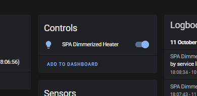

i have connected it to Home Assistant, using the esphome integration.
HA has found the device and imported it ok.
but …i dont seem to be able to automate the dimmer level. (brightness) - it doesnt seem to be exposed for remote automation.
i can remotely turn it on/off but i cannt get the brightness to change remotely.
There IS a brightness control on the Lamp card - but this isnt available remotely.
