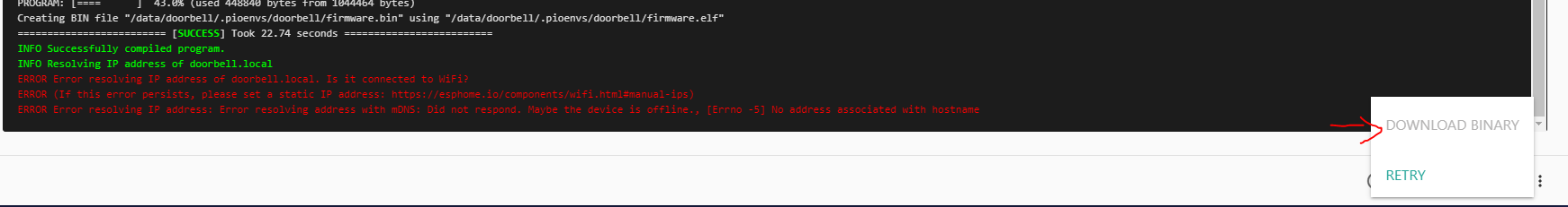

when I try “upload” via dashborad i get the error :

INFO Resolving IP address of doorbell.local
ERROR Error resolving IP address of doorbell.local. Is it connected to WiFi?
ERROR (If this error persists, please set a static IP address: https://esphome.io/components/wifi.html#manual-ips)
ERROR Error resolving IP address: Error resolving address with mDNS: Did not respond. Maybe the device is offline., [Errno -5] No address associated with hostname

Alright, so just to recap: When the ESP is connected via USB cable you can upload new firmware. And you have successfully checked that the ESP is working - did you do that by accessing the ESP’s webserver?
Now, when you try to upload a new firmware OTA then you run into the error message that you have posted.
This means that the system is trying to find the ESP via its hostname and using mDNS, but fails to do so. Maybe mDNS is not working properly in your network, or the ESP is not responding to mDNS requests as expected.
One way around this is to assign a static IP address (assuming that your router supports that) to the ESP, and configure that IP address as use_address under the wifi section.
