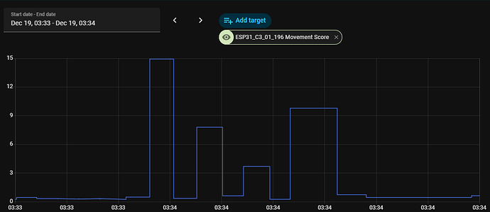

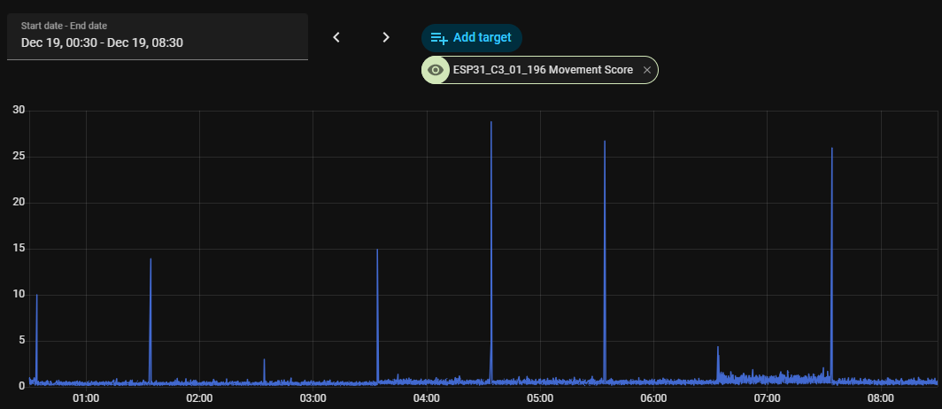

I’ve also seen something on the ESP32-C3 (that only runs with ESPectre on it), that doesn’t make sense because nobody was anywhere near the device in the middle of the night:
I’m still not sure, if this is some interference created by another device or something else.
I have four Ubiquiti APs around the house, so devices will move from one AP to another AP - strange that they would do it in the middle of the night and that these spikes are almost to the second an hour apart.
Either way, these spikes last just about long enough (2-5 seconds) to make it impossible to rely on the device for e.g. turning a light on.
