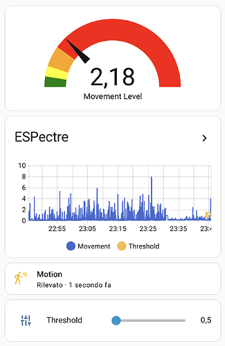

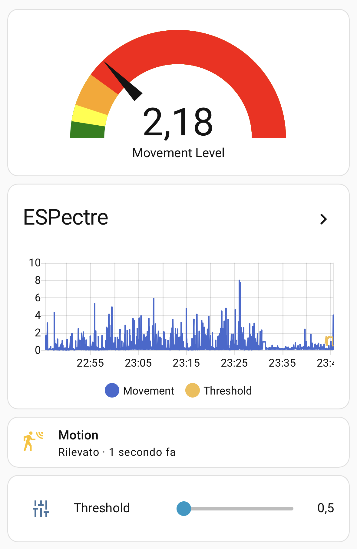

How does it integrate with Home Assistant?
ESPectre exposes:
  • Binary sensor: motion_detected (on/off)
  • Sensor: movement_score (motion intensity 0-100)
  • Number entity: threshold (adjust sensitivity from HA dashboard)
All entities are auto-discovered via ESPHome's Native API.
  1. Flash via ESPHome Dashboard or CLI
  2. Wait 10 seconds (keep room still for auto-calibration)
  3. Done! Entities appear in Home Assistant
Screenshots
