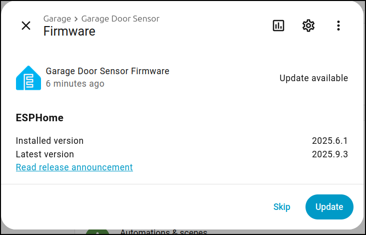

Having issues updating sensor firmware 2025-6-1 t0 2025-9-3
Getting this message but cant find any good advice on how to fix.
Help with this would be graatlu appreciated!

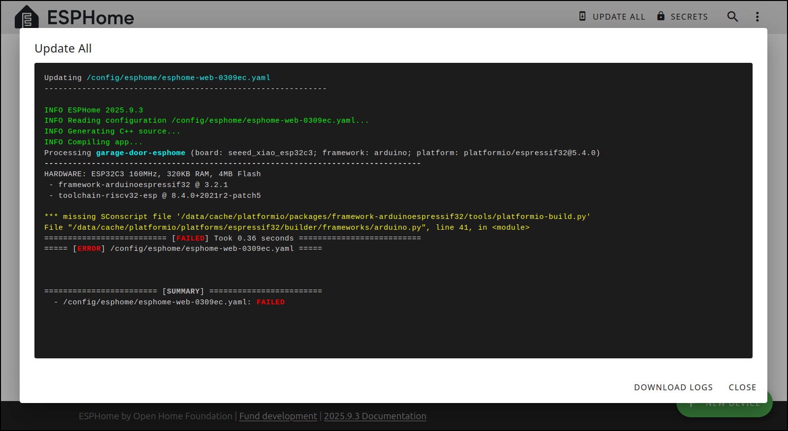

Updating /config/esphome/esphome-web-0309ec.yaml
INFO ESPHome 2025.9.3
INFO Reading configuration /config/esphome/esphome-web-0309ec.yaml…
INFO Generating C++ source…
INFO Compiling app…
Processing garage-door-esphome (board: seeed_xiao_esp32c3; framework: arduino; platform: platformio/[email protected])
HARDWARE: ESP32C3 160MHz, 320KB RAM, 4MB Flash
  • framework-arduinoespressif32 @ 3.2.1
  • toolchain-riscv32-esp @ 8.4.0+2021r2-patch5
*** missing SConscript file ‘/data/cache/platformio/packages/framework-arduinoespressif32/tools/platformio-build.py’
File “/data/cache/platformio/platforms/espressif32/builder/frameworks/arduino.py”, line 41, in
========================== [FAILED] Took 0.35 seconds ==========================
===== [ERROR] /config/esphome/esphome-web-0309ec.yaml =====
======================== [SUMMARY] ========================
  • /config/esphome/esphome-web-0309ec.yaml: FAILED

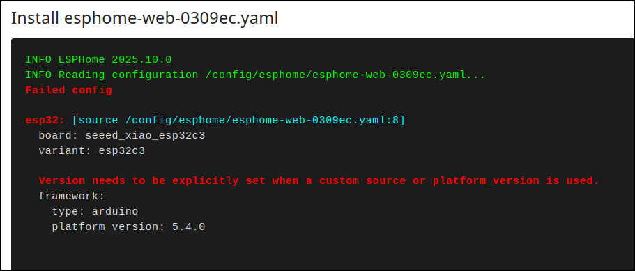

OK, I did that and now I am getting this error any further ideas?
INFO ESPHome 2025.10.0
Failed config
esp32: [source /config/esphome/esphome-web-0309ec.yaml:8]
variant: esp32c3
Version needs to be explicitly set when a custom source or platform_version is used.
framework:
type: arduino
platform_version: 5.4.0
The yaml code In case that helps

Made the above change to the yaml file which fixed the latest issue.
I needed to update the Framework.
Wondering if that might have been the issue all along?
Found this advice that helped me track down the issue
https://www.reddit.com/r/homeassistant/comments/1itc57q/psa_esphome_202520_pushes_a_breaking_change_for/?utm_source=share&utm_medium=web3x&utm_name=web3xcss&utm_term=1&utm_content=share_button
