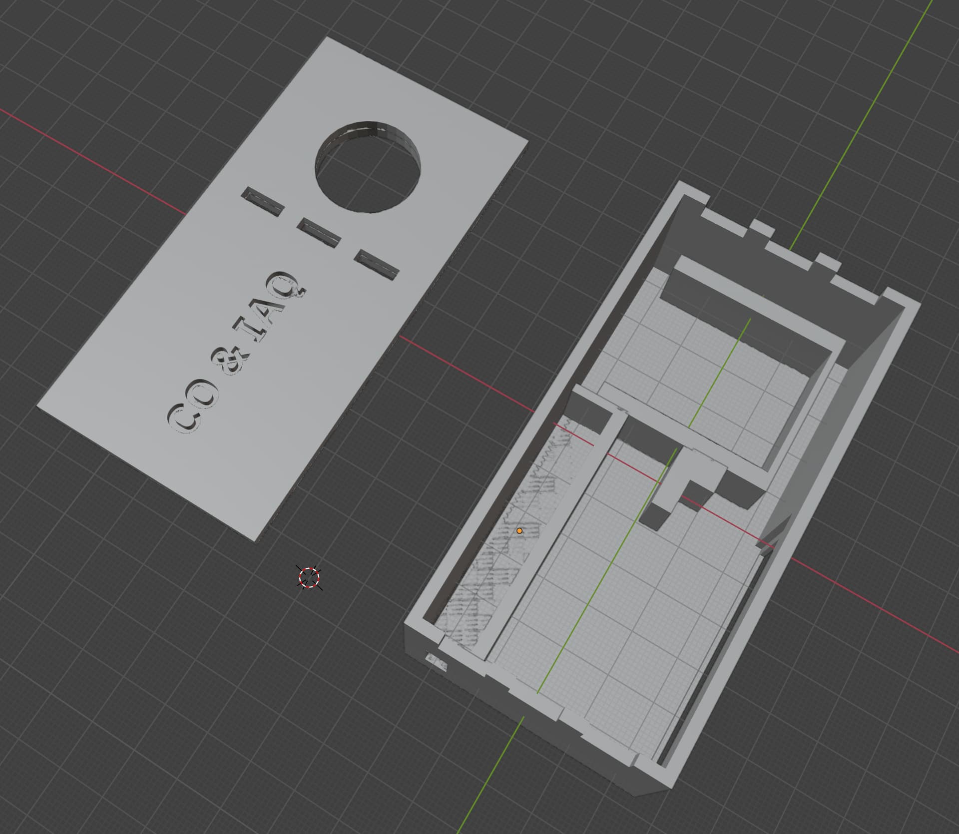

sen66 and a CO sensor Gravity: Factory Calibrated Electrochemical CO Sensor (0-1000 ppm, I2C & UART) - DFRobot when I have a min I will put the files online.
the yaml is nothing special just lifted stuff on git hub and combined it with normal configs.

For the case design, it’s advisable to check the manufacturer’s guidelines.
https://sensirion.com/media/documents/EA641247/682EF0DB/Sensirion_PS_AN_SEN6x_Mechanical_Design_and_Assembly_Guidelines.pdf
