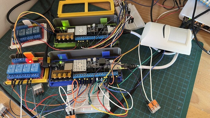

For the second part instead, I partially solved using variables and a button.
the problem
At the moment to find which sensor triggered the alarm is very hard, because you have to check in every sensors’ history if at the moment of the alarm, the sensor has been triggered or not and if it was the main cause or if it was triggered few seconds later by you when entering home to disarm the alarm.
So, I created a set of variables directly on the esp, so when a sensor is triggered its status is immediately copied into the variable and visualized on HA.
To reset these variables to the default state I have added a button.
what it does
Basically I defined an array of bool to reflect the number of input on the Konnect alarm pro

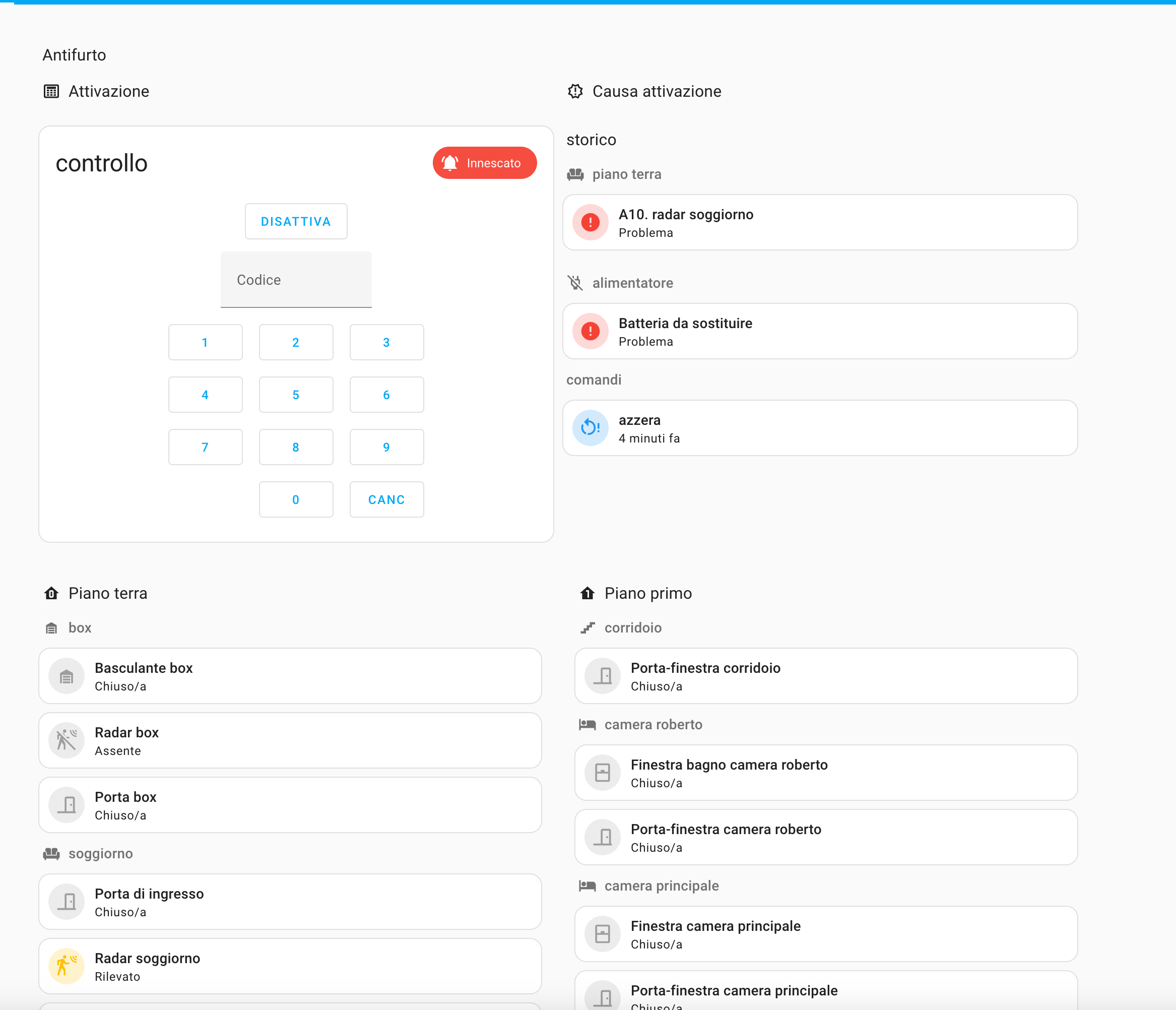

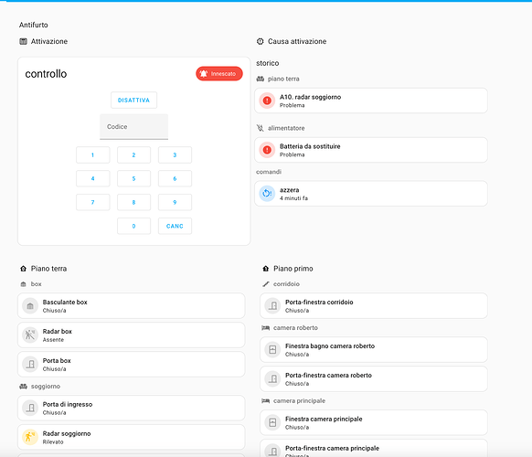

As you can see below, the alarm is triggered and on the right column I have the cause (input A10 my living room radar).
Below, a warning related to the power supply (it is ok since the battery is not connected) and finally the “azzera” button that reset the variables.

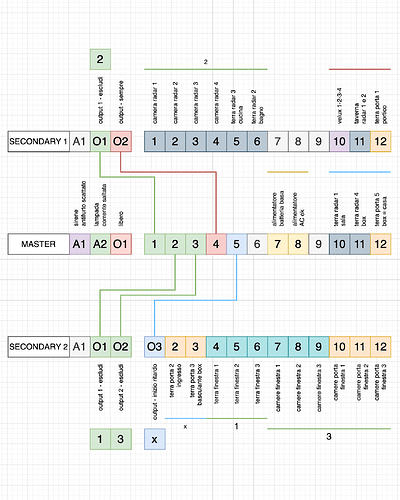

      - input: zone4                            # gruppo sempre [rele da sec 1] - radar taverna, gruppo velux e porta-finestra portico
        bypass_armed_home: false
        bypass_armed_night: false
        trigger_mode: instant
      # notte
      - input: zone1                            # gruppo escludi [rele da sec 1] - radar camere e piano terra
        bypass_armed_night: true
      # via con taparelle aperte
      - input: zone2                            # gruppo escludi [rele da sec 2] - finestre piano terra
        bypass_armed_home: true
      - input: zone3                            # gruppo escludi [rele da sec 2] - finestre/porte-finestre piano superiore
      # con ritardo
      - input: zone5                            # gruppo inizio ritardo [rele da sec 2] porta ingresso o basculante box
        chime: true
        trigger_mode: delayed
      - input: zone10                           # radar 1 - terra - soggiorno
        bypass_armed_home: false                # escluso se se va via con finestre aperte
        bypass_armed_night: true                #
        trigger_mode: delayed_follower
      - input: zone11                           # radar 4 - terra - box
        bypass_armed_night: true                # posso andare nel box di notte
      - input: zone12                           # sensore - terra - porta - box/soggiorno

              id(zone_alm_pre_set)[10] = true;
  - id: !extend zone11                          # radar 4 - terra - box
    device_class: motion
    on_press:
      then:
        - lambda: |-
            if ((id(zone11).state) && (id(stato_antifurto).state == 3 || id(stato_antifurto).state == 4 || id(stato_antifurto).state == 5)) {
              id(zone_alm_pre_set)[11] = true;
  # finestre
  - id: !extend zone2                           # sensore - [da sec 2] gruppo finestre piano terra
    device_class: window
    on_press:
      then:
        - lambda: |-
            if ((id(zone2).state) && (id(stato_antifurto).state == 3 || id(stato_antifurto).state == 4 || id(stato_antifurto).state == 5)) {
              id(zone_alm_pre_set)[2] = true;
  - id: !extend zone3                           # sensore - [da sec 2] gruppo finestre e porte finestre piano superiore
    on_press:
      then:
        - lambda: |-
            if ((id(zone3).state) && (id(stato_antifurto).state == 3 || id(stato_antifurto).state == 4 || id(stato_antifurto).state == 5)) {
              id(zone_alm_pre_set)[3] = true;
  # varie
  - id: !extend zone4                           # sensore/radar - [da sec 1] gruppo: velux, radar taverna e porta-finestra portico
    on_press:
      then:
        - lambda: |-
            if ((id(zone4).state) && (id(stato_antifurto).state == 3 || id(stato_antifurto).state == 4 || id(stato_antifurto).state == 5)) {
              id(zone_alm_pre_set)[4] = true;
  # porte
  - id: !extend zone5                           # sensore - terra - [da sec 2] porta ingresso o basculante
    device_class: door
    on_press:
      then:
        - lambda: |-
            if ((id(zone5).state) && (id(stato_antifurto).state == 3 || id(stato_antifurto).state == 4 || id(stato_antifurto).state == 5)) {
              id(zone_alm_pre_set)[5] = true;
  - id: !extend zone12                          # sensore - terra - porta box-soggiorno
    device_class: door
    on_press:
      then:
        - lambda: |-
            if ((id(zone12).state) && (id(stato_antifurto).state == 3 || id(stato_antifurto).state == 4 || id(stato_antifurto).state == 5)) {
              id(zone_alm_pre_set)[12] = true;
  # basculante box
  # virtuali - storico attivazione
  - platform: template
    device_class: problem
    lambda: |-
      if (id(zone_alm_pre_set)[1] && id(stato_antifurto).state == 7) {
        return true;
      } else if (!id(zone_alm_pre_set)[1] && id(stato_antifurto).state != 7) {
        return false;
      return id(zone01_alm).state;
    lambda: |-
      if (id(zone_alm_pre_set)[2] && id(stato_antifurto).state == 7) {
        return true;
      } else if (!id(zone_alm_pre_set)[2] && id(stato_antifurto).state != 7) {
        return false;
      return id(zone02_alm).state;
    lambda: |-
      if (id(zone_alm_pre_set)[3] && id(stato_antifurto).state == 7) {
        return true;
      } else if (!id(zone_alm_pre_set)[3] && id(stato_antifurto).state != 7) {
        return false;
      return id(zone03_alm).state;
    lambda: |-
      if (id(zone_alm_pre_set)[4] && id(stato_antifurto).state == 7) {
        return true;
      } else if (!id(zone_alm_pre_set)[4] && id(stato_antifurto).state != 7) {
        return false;
      return id(zone04_alm).state;
    lambda: |-
      if (id(zone_alm_pre_set)[5] && id(stato_antifurto).state == 7) {
        return true;
      } else if (!id(zone_alm_pre_set)[5] && id(stato_antifurto).state != 7) {
        return false;
      return id(zone05_alm).state;
    lambda: |-
      if (id(zone_alm_pre_set)[6] && id(stato_antifurto).state == 7) {
        return true;
      } else if (!id(zone_alm_pre_set)[6] && id(stato_antifurto).state != 7) {
        return false;
      return id(zone06_alm).state;
    lambda: |-
      if (id(zone7).state) {
        id(zone_alm_pre_set)[7] = true;
      return id(zone_alm_pre_set)[7];
    lambda: |-
      if (!id(zone8).state) {
        id(zone_alm_pre_set)[8] = true;
      return id(zone_alm_pre_set)[8];
    lambda: |-
      if (id(zone_alm_pre_set)[9] && id(stato_antifurto).state == 7) {
        return true;
      } else if (!id(zone_alm_pre_set)[9] && id(stato_antifurto).state != 7) {
        return false;
      return id(zone09_alm).state;
    lambda: |-
      if (id(zone_alm_pre_set)[10] && id(stato_antifurto).state == 7) {
        return true;
      } else if (!id(zone_alm_pre_set)[10] && id(stato_antifurto).state != 7) {
        return false;
      return id(zone10_alm).state;
    lambda: |-
      if (id(zone_alm_pre_set)[11] && id(stato_antifurto).state == 7) {
        return true;
      } else if (!id(zone_alm_pre_set)[11] && id(stato_antifurto).state != 7) {
        return false;
      return id(zone11_alm).state;
    lambda: |-
      if (id(zone_alm_pre_set)[12] && id(stato_antifurto).state == 7) {
        return true;
      } else if (!id(zone_alm_pre_set)[12] && id(stato_antifurto).state != 7) {
        return false;
      return id(zone12_alm).state;
I connected 3 Konneted :sweat_smile: using wires (grouping floor sensors, like motion on upper floor) so the alarm can work even when the network is down.
Something like this:
If a radar detect motion on the upper floor, the alarm panel on the master will be triggered by the “upper floor motion sensors”, and on HA I will have the right sensor on the history (since the code with variable is even on the secondary Konnected)
but now it live on my desk covered by stuff and dust… :sob:
Sorry, I wrote it in hurry so maybe there will be a lot of typo and grammar errors (as you probably noticed English is not my main language).

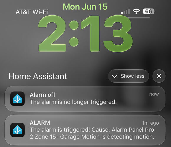

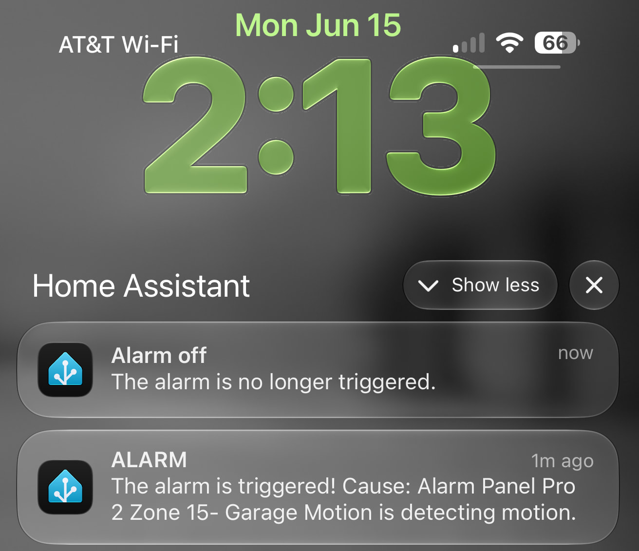

Not sure what changed, but my basic install just started reporting which zone caused the Alarm
