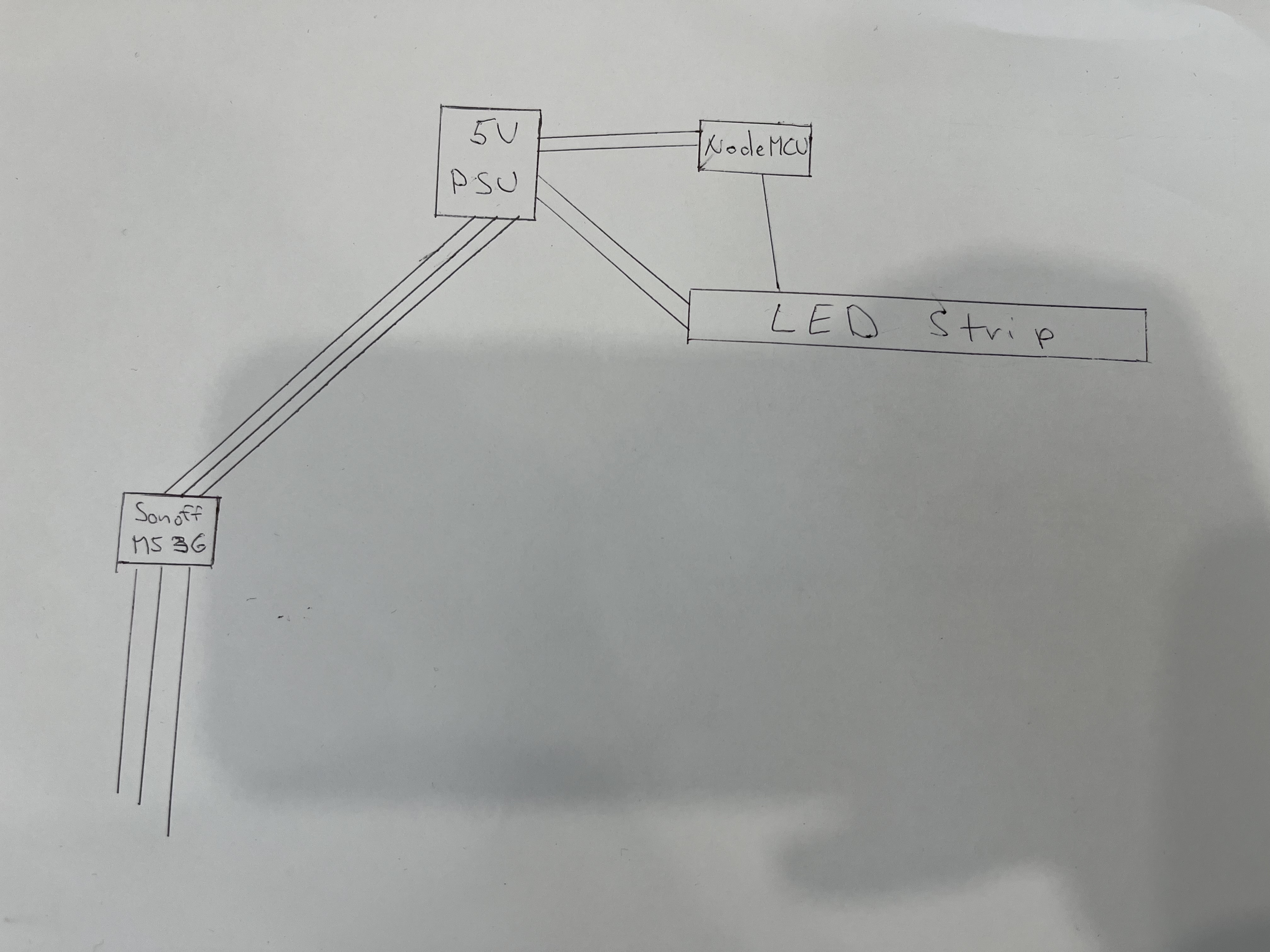

Attached is a diagram that I have in my mind to implement this. This diagram is simple because there is not much logic needed.
The problem is that, what I want to achieve, I am not sure if this is the right setup and the second thing is the config on esphome (sonoff m5 in this case).
If you want to keep esphome on the M5, just remove the relay output in the config so it doesn’t turn the 5V PSU on and off and connect the PSU to the live, not relay output. The switch in the M5 can still be used as a trigger for a HA automation to turn the WLED on and off.
Alternatively, leave the relay output and use that to turn on the 5V PSU, you can set WLED to a preset on power on
