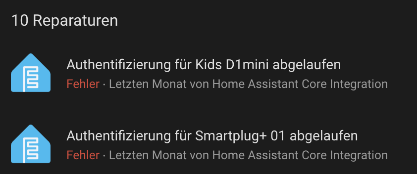

All of my ESPhome devices seem to need their API key reinstating every 12 hours or so at random. I have a full list of repairs for ESPHome devices. I haven’t changed anything on the ESPHome devices. Sometimes just clicking on the repair is enough, and sometimes it brings up the windows to paste in the API key.
How might I resolve this?

I have that “picture” in Integrations view:
IMHO AFAIK ESPHome devices anyway will be show grouped under same Integration regardless of same of different api encryption keys.
