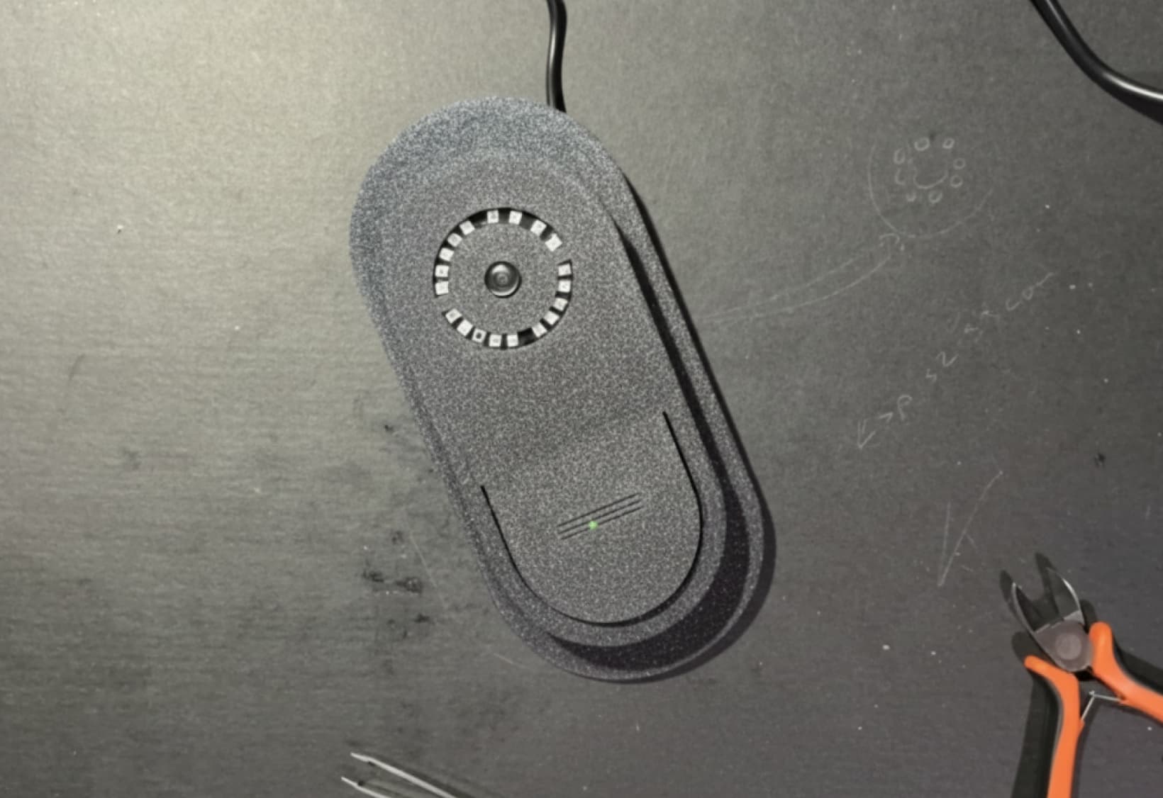

I updated my custom DIY smartbell
I’m using;
  • Esp32-s3 cam module with and ov2640 wide-angle camera
  • LD2410c mmwave sensor for presence detection
  • IR LED ring for nightvision
  • And a good old push button :slight_smile:
Here is the build process.
Github repo for the code and STL: GitHub - rgnyldz/rgnlabs-smartbell: This is the esphome yaml code for the Smartbell V2.

But my main goal was to have a fully local all-in-one doorbell. Lot’s of possibilities come with presense sensor for example :slight_smile:
I’m recording 24/7 BTW into my proxmox. Have a dedicated HDD for it :slight_smile:
I used an ESP32-S3 Cam instead of the regular esp32-cam models. The picture is actually quite better than I expected TBO.
Also I like to build my stuff myself. Primarily because of independency but also mostly because it’s a fun hobby for me.
