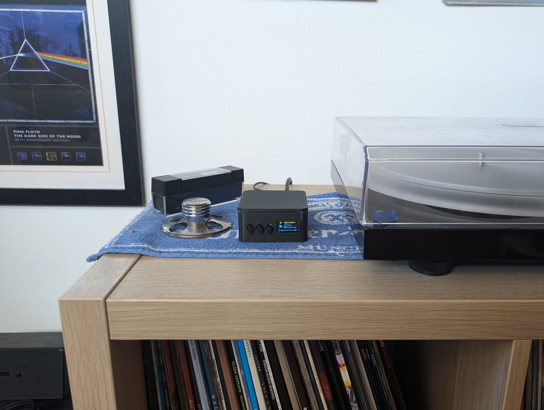

BTW here are some photos/screens of my setup
Here is my little friend playing from Sendspin source :

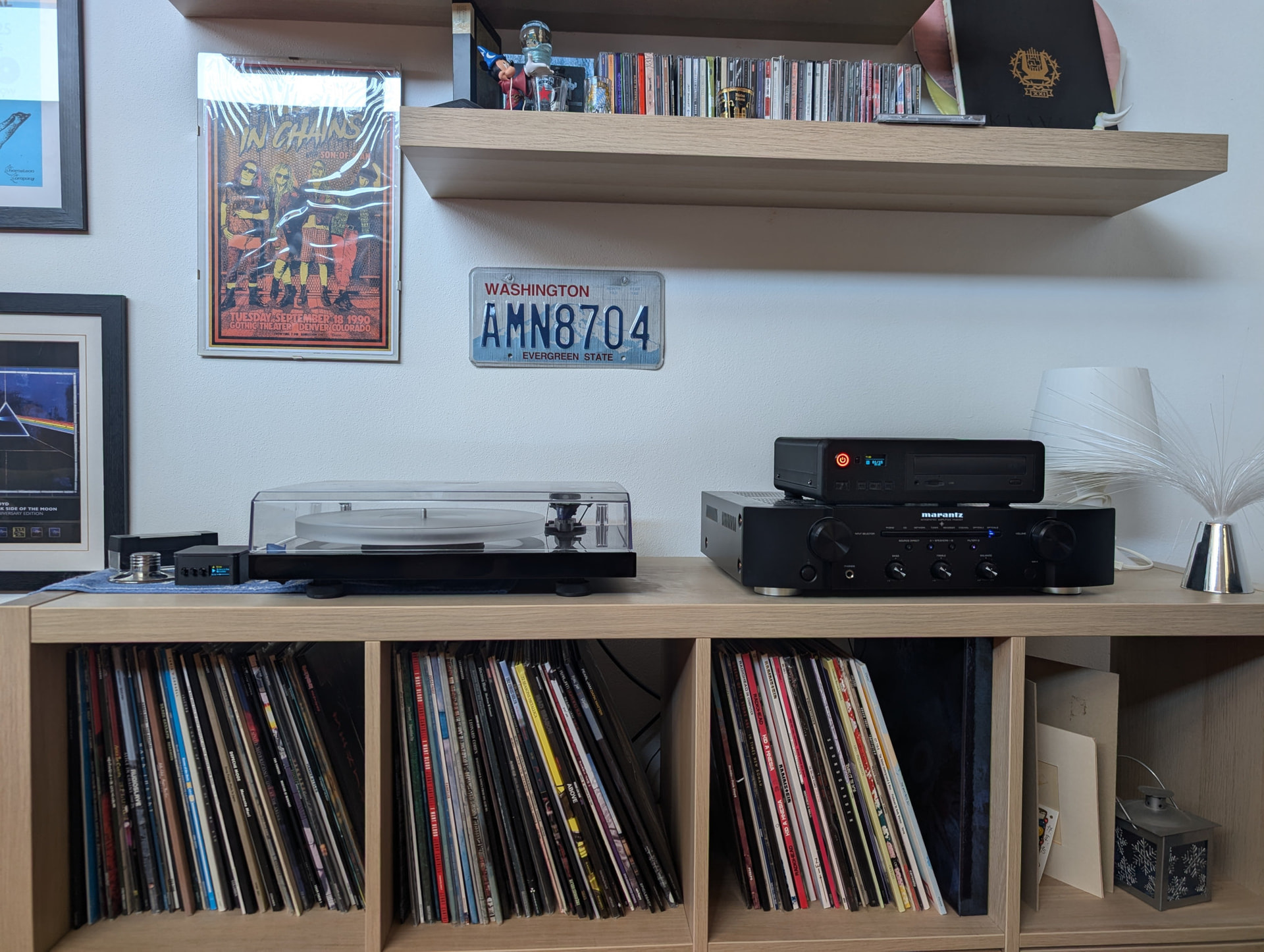

This is my complete Rig… Who does need Spotify when you have LPs, CDs, Music Assistant & Bluetooth? :slightly_smiling_face:
BTW The CD Player is an ESP8266 with ESPHome and ATAPI Module to interface with the IDE CD Player. The Player itself is connected to the Hi-Fi via Digital (Yep another SPDIF interface here), so completely lossless. 400€ Quality sound, smart connected, with a recovered old CD Player and a sub 1€ ESP8266 :love_you_gesture:

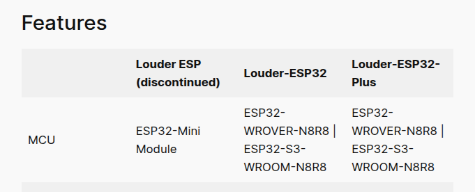

No problem and thanks for the trick regarding external_components but in all matters it’s a dead issue as A2DP is only possible only on ESP32 with Bluetooth and not only Bluetooth BLE so only possible with ESP-32 and ESP32-S31 as of today (perhaps you should indicate it more clearly on github to avoid others doing same mistake as me :wink:
Yes, unfortunately only the Louders with a bare ESP32 (the WROVER, not the S3 ones) are supported, because of lacking Bluetooth Classic support.
I’ve update the readme to better clarify that.
Tecnically you could use another ESP32 (Even the base WROOM, they’re cheap and you can find them for 3$), and connect it via I2S to the louder to get A2DP, but it’s a long journey to get it done…
Is it possible to use BT as audio output, not input, in this project?
Yeah the best way would be probably to replace the ESP32 chip of the Louder with the one supporting bull BT but I don’t have enough soldering skills to do that without destroying the printed circuit board :rofl:
Nope, this is only for A2DP Sink. What you need is A2DP Source functionality, which is a totally different implementation. Anyway, WiFi and BT cannot coexist for massive data transfer at the same time, so you’d need an Ethernet module and use the WiFi radio only for BT.
Or more simply, replace the louder 32 with the same model based on the bare ESP32 :slight_smile: I’ve seen from they’re website they sell same models with either ESP32-S3 and ESP32 WROVER (the bare ESP32 + PSRAM) variants (That’s why I initially answered you it should be supported):
Maybe check if you are lucky enough to have the ESP32-WROVER variant over the S3 (which is more powerful but has no A2DP)
