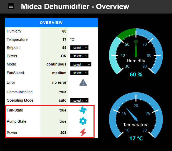

Thank you for providing your solution.
I’ve been working on the same issue for a few weeks now.
My skills for integrating it into Esphome aren’t yet sufficient.
Therefore, I started my project with Tasmota with Berry
I wanted to point out that the dehumidifier also provides temperature in addition to relative humidity.

Furthermore I use also a Power-Plug to detect the state of the compressor and fan.
Power > 10 && Power < 100 ==> Fan is running
Power > 100    ==> Fan and compressor are running
