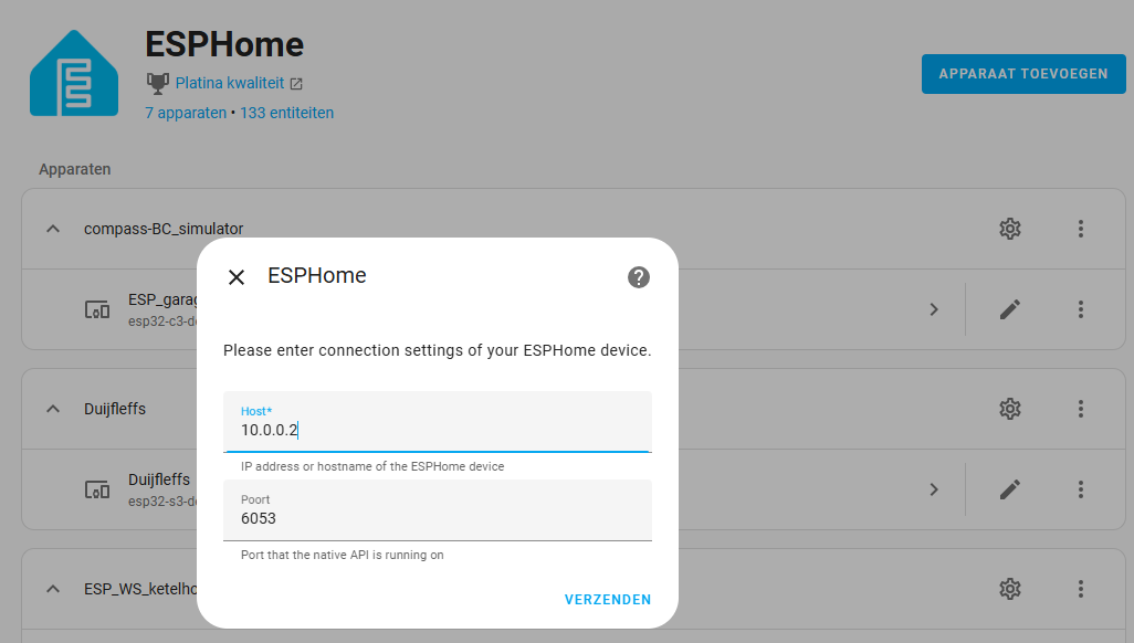

this is where i set the static tunnel ip to the esp, this is also what changes to a local ip if i leave mdns on.
sensors from this intergation part work fine!
