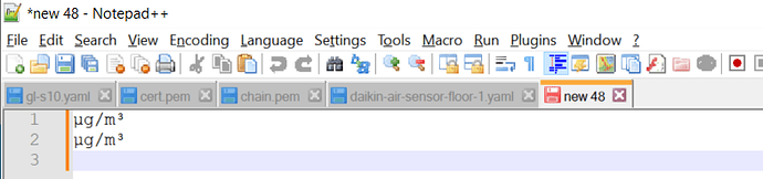

2023-06-12 13:33:44.531 WARNING (MainThread) [homeassistant.components.sensor] Entity sensor.daikin_air_sensor_floor_1_pm1 (<class 'homeassistant.components.esphome.sensor.EsphomeSensor'>) is using native unit of measurement 'μg/m³' which is not a valid unit for the device class ('pm1') it is using; expected one of ['µg/m³']; Please update your configuration if your entity is manually configured, otherwise create a bug report at https://github.com/home-assistant/core/issues?q=is%3Aopen+is%3Aissue+label%3A%22integration%3A+esphome%22
2023-06-12 13:33:44.546 WARNING (MainThread) [homeassistant.components.sensor] Entity sensor.daikin_air_sensor_floor_1_pm2_5 (<class 'homeassistant.components.esphome.sensor.EsphomeSensor'>) is using native unit of measurement 'μg/m³' which is not a valid unit for the device class ('pm25') it is using; expected one of ['µg/m³']; Please update your configuration if your entity is manually configured, otherwise create a bug report at https://github.com/home-assistant/core/issues?q=is%3Aopen+is%3Aissue+label%3A%22integration%3A+esphome%22
2023-06-12 13:33:44.619 WARNING (MainThread) [homeassistant.components.sensor] Entity sensor.daikin_air_sensor_floor_1_tvoc (<class 'homeassistant.components.esphome.sensor.EsphomeSensor'>) is using native unit of measurement 'μg/m³' which is not a valid unit for the device class ('volatile_organic_compounds') it is using; expected one of ['µg/m³']; Please update your configuration if your entity is manually configured, otherwise create a bug report at https://github.com/home-assistant/core/issues?q=is%3Aopen+is%3Aissue+label%3A%22integration%3A+esphome%22
2023-06-12 13:33:44.639 WARNING (MainThread) [homeassistant.components.sensor] Entity sensor.daikin_air_sensor_floor_1_pm10 (<class 'homeassistant.components.esphome.sensor.EsphomeSensor'>) is using native unit of measurement 'μg/m³' which is not a valid unit for the device class ('pm10') it is using; expected one of ['µg/m³']; Please update your configuration if your entity is manually configured, otherwise create a bug report at https://github.com/home-assistant/core/issues?q=is%3Aopen+is%3Aissue+label%3A%22integration%3A+esphome%22
What is wrong or missing?

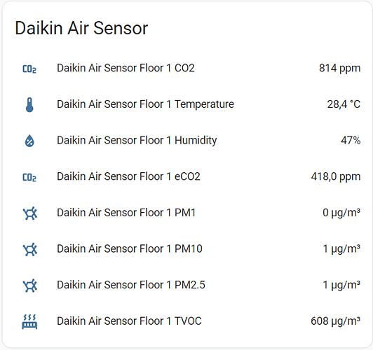

The ESPHome version is 2023.2.4 and Home Assistant is 2023.4.6. If somebody is looking after the same this is how it looks like:
. Don’t know any other way to do it…
