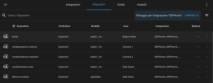

For example I have this device “boiler” which does not appear in the esphome device list but it appears in the device list. In that way I’m not able to manage (remove) and try to re-add it.
The fun fact is that it also send some sensor status like temperature and energy.
I’ve tried to simply re-add the integration (boiler.local) but it says “device already configured”.
I’ve also tried removing it from config/.storage/core.device_registry. It didn’t appear for a while in either device window or espHome device, but it was still unavailable, and now we are back to normal as in the screenshots before.
