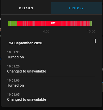

Yesterday I set up a brand new Gosund SP-1 plug with the latest ESPHome 1.14.x (using the API, not MQTT), and I also experienced disconnections to both Home Assistant and the ESPHome log viewer constantly, with each connection lasting no more than 3 minutes in general.
I tried several things, including changing the WiFi SSID (I have 2 access points, but this happened with both), WiFi power mode, etc.
Today I saw @orange-assistant’s answer, and tried flashing ESPHome 1.15.0b3 to see if that would work. As of now, I haven’t had any disconnection and the plug works wonderfully!
Image: The disconnections can be seen throughout the status bar. After flashing the beta release, you can see the switch status stays in the ā€˜on’ position without being disconnected.
So, at least for me, it seems like some recent change has fixed these issues.
I’ll post another update here after some time has passed, so I can tell you how everything went, and whether the problem came back.
