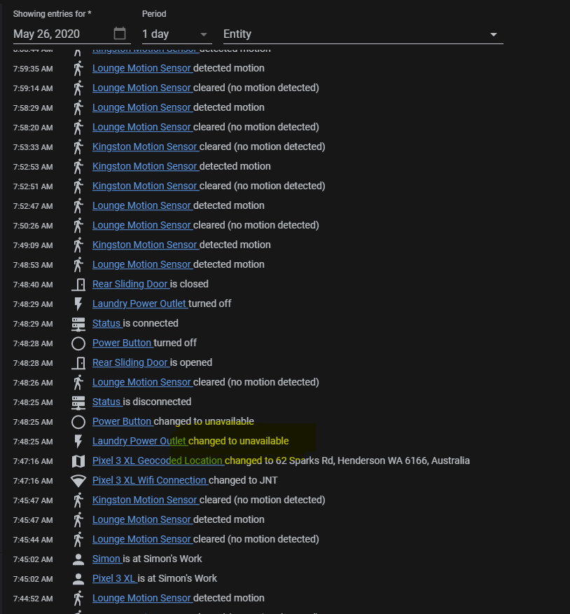

OK, I did as you suggested and I now have about 80% fewer ā€œdevice unavailableā€ issues.
I have 2 since midnight, but it’s a whole lot better.
I’ll disable band steering tonight tonight and see if that improves things further.

@SimonPth This was a really tough nut to solve. Took me 2 days of intense study, and the ā€œfixā€ was so simple. Now the devs need to figure out what’s really going on…

That is interesting. I will try removing Fingbox, however, what I also noticed today is that restarting HA resolves the issue, albeit temporarily.

I’m not losing connection to the network either. It’s just the ESPHome-HA API pipe that breaks.
