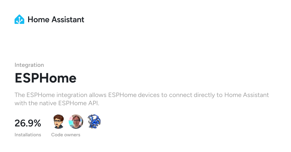

I think you are mixing two things up there. That yaml is your docker compose file to start the ESPHome Device Builder container on port 6052. The Error about the API key is related to a specific device YAML section and is documented here:
It’s so HA core can communicate with the specific ESP device, and that device’s config is in /home/opt/esphome/config – that’s where the api key goes.
