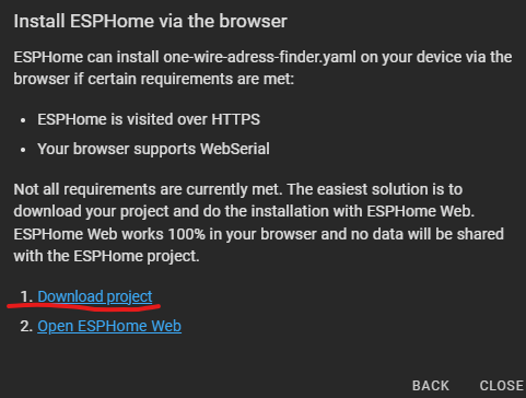

In ESPHome Builder create the .bin file via Install ESPHome via the browser.
