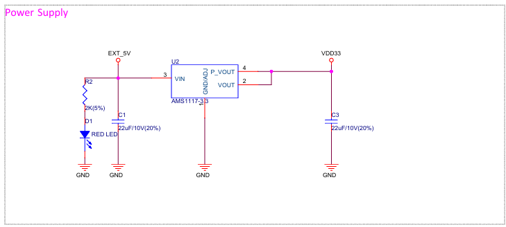

Power-LED is indicating your board is powered on…

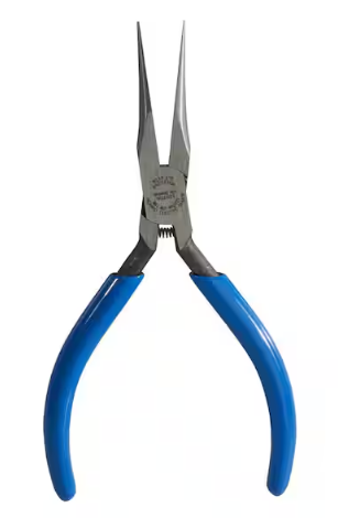

You can desolder it, pry it with pliers or cover it. Covering is safer though…
as said, you can’t turn it off, since it’s tied to input 5V voltage:
