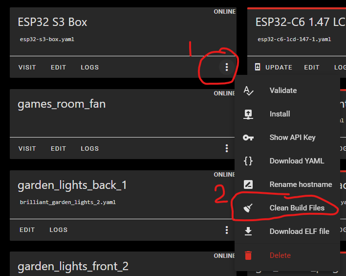

Try clearing the build files.
Having said that, is your machine connected to internet? Looks like it’s failing to download what it needs… or failing to save files?
thanks for your answer. i cleared the build files
