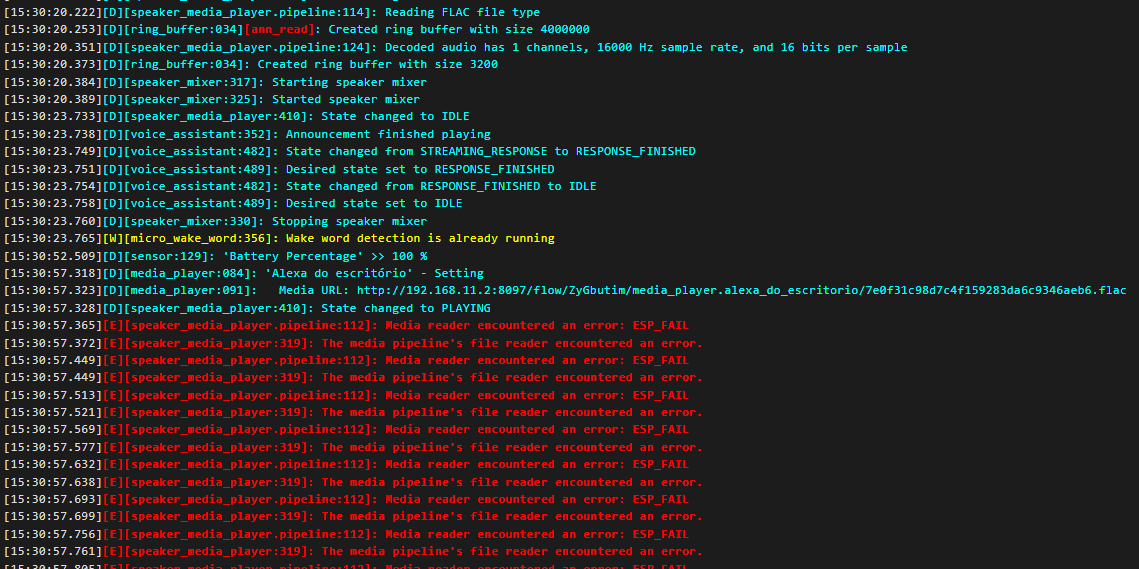

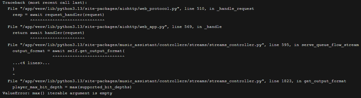

The voice assist pipeline works perfectly, but it breaks the media pipeline as shown below:

Hmmm. I’m not sure why it would have broken the media pipeline unless you’re doing something in the yaml like stopping the speaker but not restarting it. I can play both media and announcements from HA .

After further investigation my problem seems to be the media player not sending the max_bit_depth to music assistant
Adding bits_per_sample to the speaker setting makes the player stream indefinitely, but still no sound and the same error in the end
Speaker, mixer, media player, mww and va configs seems to be ok
Voice replies (TTS) and wake word detections work 100% of the time after @gtjoseph PR was merged. Only music stream from music assist thats buggy
