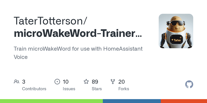

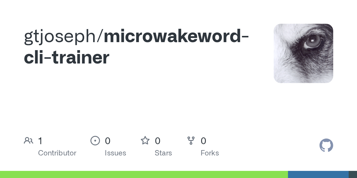

Before you go down the trainer route, there are a bunch out there already, including mine. :slight_smile:
I based mine on @TaterTotterson 's and he then incorporated some of my stuff back into his. That’s not to say ours are perfect or fit everyone’s needs so if you do decide to create your own, you can at least get some good ideas from ours.
Getting stuff merged into ESPHome can be a bit of a pain the first time so I wouldn’t blame you for making that a lower priority. It’s just something to think about when you’ve run out of other stuff to do. :slight_smile:
Great, then, if they already work well, I’ll avoid wasting time and use yours. From my research, I hadn’t seen yours in particular. I knew about Totter’s, but I HATE ipnyb notebooks. I started with a CUDA-only approach, and was trying with IPA phonetics. Getting an English TTS to speak in Italian to generate samples is a real pain. Then sample generation + sample generation, not just Libritts but also others, then similar samples to use as negative examples, and then the classic training with noise/background noise, etc.
Yeah that was my reason for going the CLI route. Anyway, feel free to take whatever you need from my repo if it’ll help. The training process is kind of a black art so good luck!
