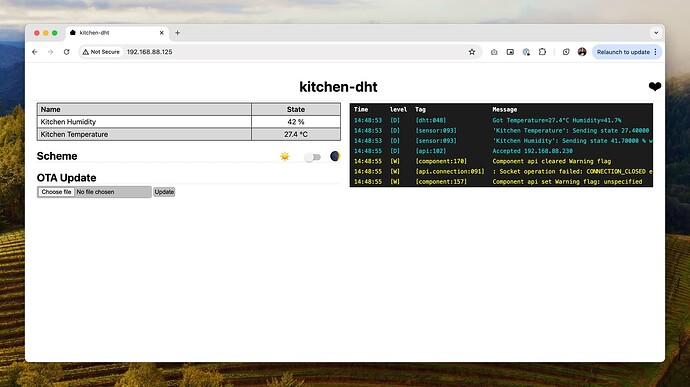

By direct access in the browser the ESPHome shows the log and data. Even the port is responding from the laptop.

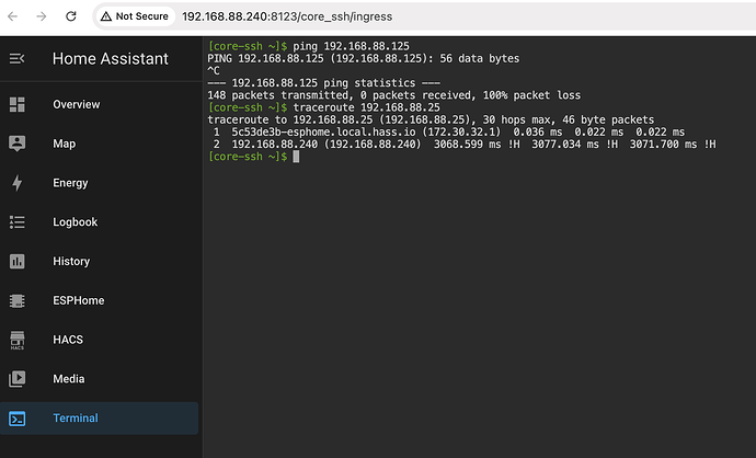

But when I’m trying to ping the local IP 192.168.88.125 from the terminal on HA – it’s not reachable.

Screenshot of the ping and of the ESPHome in the browser attached. You can see in the log that I’ve tried to connect to the port 6053 from laptop with a command “nc -z -v 192.168.88.125 6053”.
