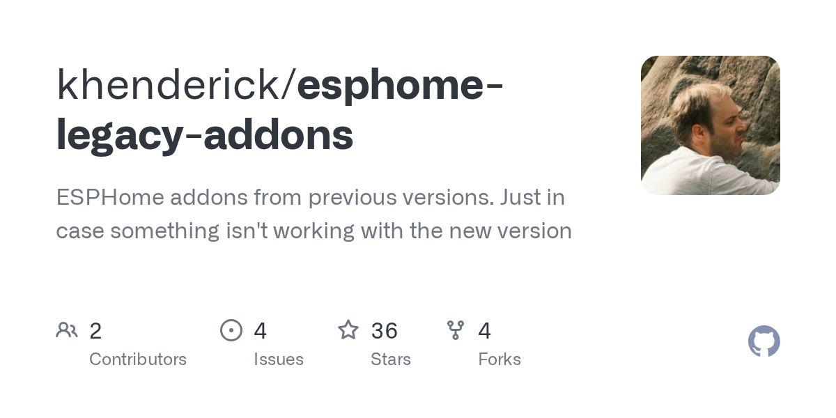

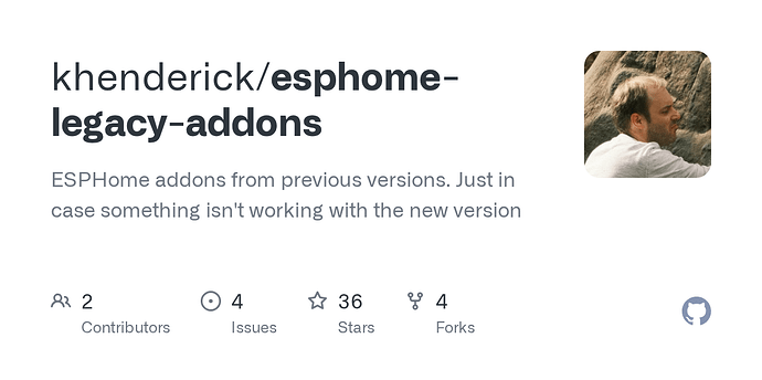

You can easily try and see if it compiles ok with the old version using this add-on:
Legacy ESPHome versions repository
You can then compare Builder logs and see where it is going wrong (Not the compile logs - the ESPHome Builder logs).
