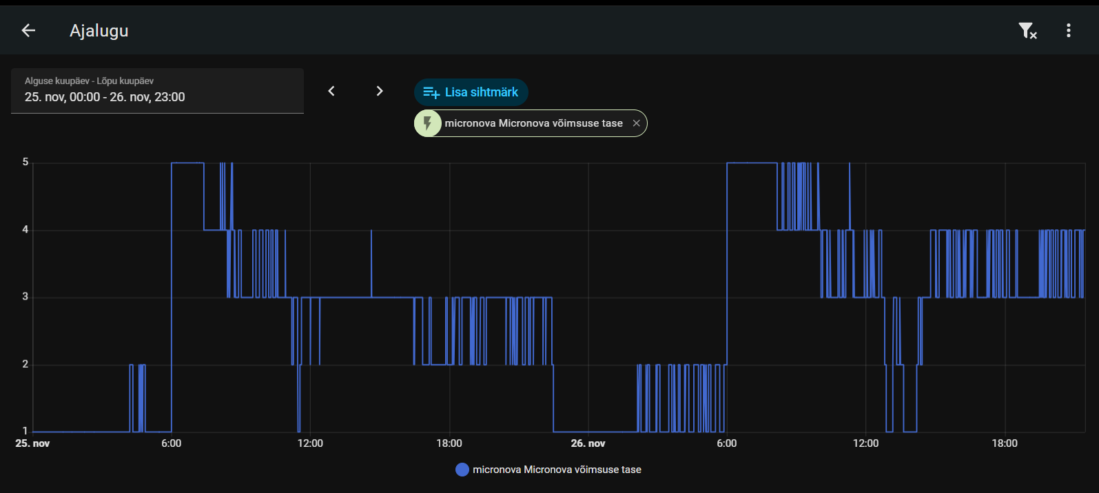

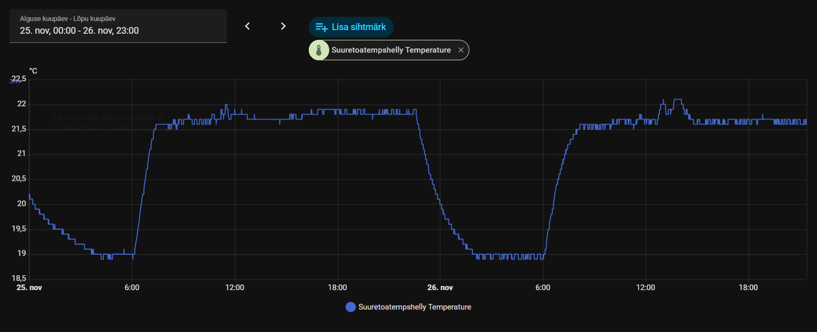

You want control room temperature without temperature sensor? Stove temp sensor is controllable.I control stove power with external temp sensor,no need extra relay or another esp.Sorry for my english.
My stove is located in another building, so external ntc probe is problematic. I can’t get it to work - stove does not seem to react to external thermostat either I connect a relay or fixed ntc probe (10k). All options I can set with esphome micronova component also seem to have no effect except for on/off switch. My stove uses L023-7 micronova board and is made by MCZ (red compact 24).
Maybe i dont understand your problem exactly,but you no need wired sensor.I have shelly blu sensor in esphome(micronova esp node),made another thermostat and it controls power of stove.works nicely
micronova:
  enable_rx_pin: GPIO23
  update_interval: 20s
uart:
  tx_pin: GPIO1
  rx_pin: GPIO3
  baud_rate: 1200
  data_bits: 8
  stop_bits: 2
  parity: NONE
sensor:
  - platform: template
    unit_of_measurement: "°C"
    accuracy_decimals: 2
    lambda: |-
      return id(shellytemp).state - id(ketty_thermostaat).target_temperature;
    on_value:
      then:
        - script.execute: update_kamina_power
  - platform: homeassistant
    entity_id: sensor.suuretoatempshelly_temperature
  - platform: micronova
    room_temperature:
      name: Micronova Ruumi andur
    fumes_temperature:
      name: Micronova suitsugaasi temp
    stove_power:
    fan_speed:
      fan_rpm_offset: 240
      name: Micronova ventika kiirus
    memory_address_sensor:
      memory_location: 0x20
      memory_address: 0x7d
      name: Custom Address sensor
script:
  - id: update_kamina_power
    mode: restart
    then:
      - if:
          condition:
            sensor.in_range:
              below: -0.4
          then:
            - number.set:
                value: 5
      - if:
          condition:
            sensor.in_range:
              below: -0.3
              above: -0.4
          then:
            - number.set:
                value: 4
      - if:
          condition:
            sensor.in_range:
              below: -0.2
              above: -0.3
          then:
            - number.set:
                value: 3
      - if:
          condition:
            sensor.in_range:
              below: -0.1
              above: -0.2
          then:
            - number.set:
                value: 2
      - if:
          condition:
            sensor.in_range:
              above: 0
          then:
            - number.set:
                value: 1
text_sensor:
    stove_state:
number:
    thermostat_temperature:
      name: Micronova termostaadi temp
      step: 1
    power_level:
      name: Micronova võimsuse tase
switch:
    stove:
      name: Micronova on/off switch
climate:
  - platform: thermostat
    name: "Ketty võimsusjuhtimine"
    sensor: shellytemp
    heat_deadband: 0.1
    heat_overrun: 0.0
    visual:
      min_temperature: 15
      max_temperature: 30
      temperature_step: 0.1
    min_heating_off_time: 20s
    min_heating_run_time: 20s
    min_idle_time: 2s
    heat_action: []
    idle_action: []
    preset:
      - name: Kodus
        default_target_temperature_low: 22 °C
      - name: Eemal
        default_target_temperature_low: 19 °C
and power:
Thank you for the info. I see how it’s done. Not sure my stove responds properly to it’s “power” number - it’s acting a bit wierd.
